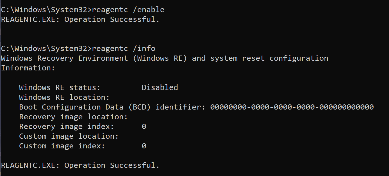

I am unable to enable WindowsRE?

    Well I think I'll just have to live without Windows RE sadly. I ran the commands above with a bootable usb of windows to the volume, and then rebooted to attempt to enable Windows RE but it still refuses to actually get enabled.
