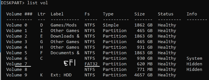

    List  Vol<<<List the volumes & letters
    Select  Vol  7           <<<Select EFI -- I guess it's still Volume 7
    Assign  Letter=S     <<<Give it letter S -- unless List Vol shows it's already there
    Exit<<<Exit Diskpart
    BCDBoot  C:\Windows  /s  S:  /f  UEFI <<< **** Rebuild the BCD in EFI & all other boot files.

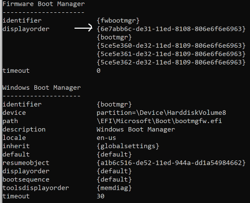

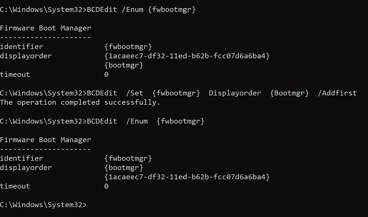

    (1) Now that you've got a new BCD, show us: BCDEdit /Enum {fwbootmgr}
    That is a window to the BIOS Boot Order screen. The earlier BCD showed BIOS was set to boot directly to C instead of to the Windows Boot Manager (bootmgr). A UEFI installation should always boot to the boot manager.
    If it still looks like that, move {bootmgr} to the top of the Displayorder this way...
    BCDEdit /Set {fwbootmgr} Displayorder {Bootmgr} /Addfirst
    BCDEdit /Enum {fwbootmgr} <<<Confirm it has moved to the top
    Reboot to put it into effect. It will automatically change in BIOS. Then show us the full BCD...
    BCDEdit /Enum All

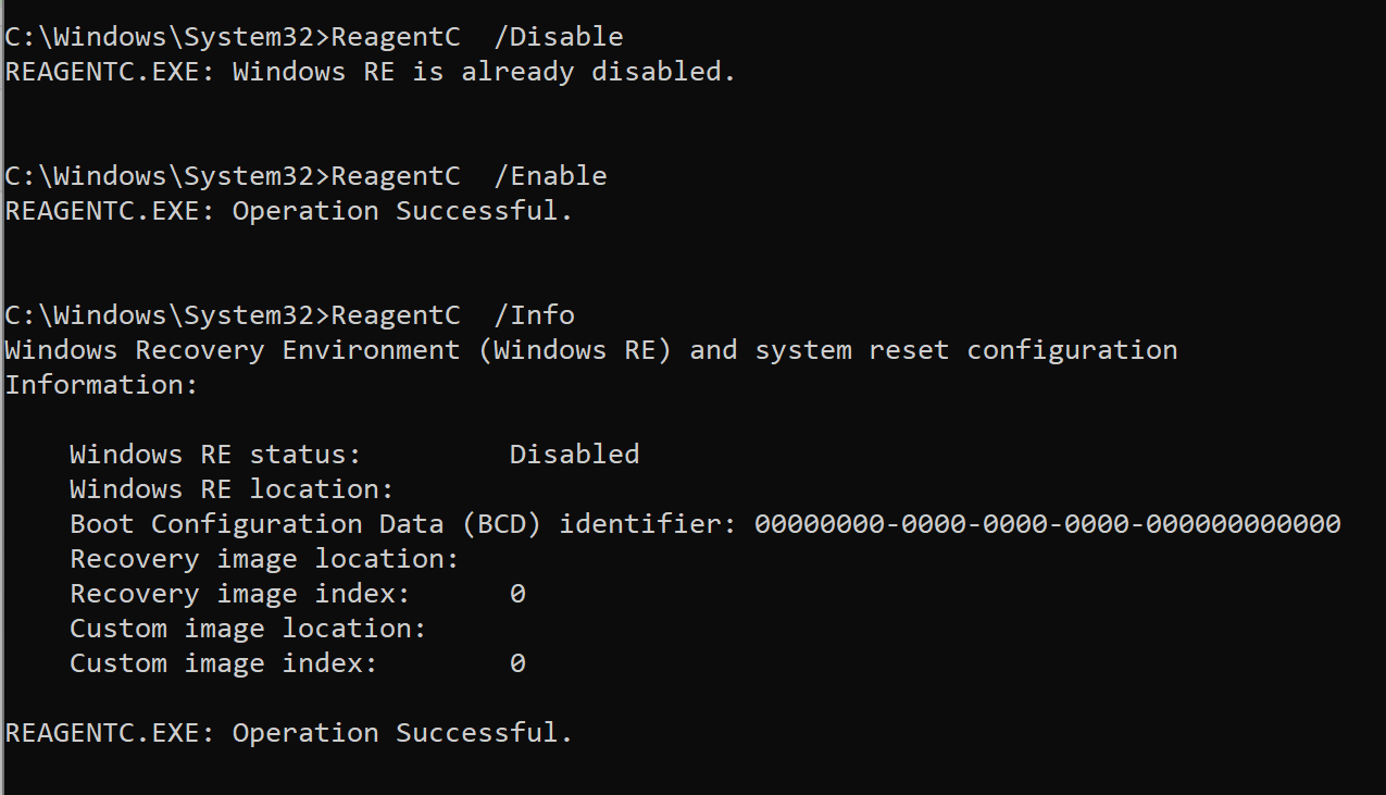

    (2) Now try...
    ReagentC /Disable <<<Moves WinRE.wim to staging area
    ReagentC /Enable <<<Moves it to the Recovery partition
    ReagentC /Info <<<Show whether it is enabled
    If it isn't enabled, let's see C:\Windows\Logs\ReAgent\Reagent.log. Just copy/paste the output of those three commands from the bottom of the log.
    2023-04-20T10:54:51+00:00
    The above is before a reboot with those commands.
    Below is after a reboot

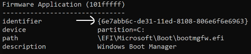

    Edit- I feel like the identifier for the BCD shouldnt be all zeros? Is that a sign of something being broken?>
    2023-04-20T22:41:51+00:00
    (1) No, the zero GUID /Info reported means none was found in the BCD for the Recovery partition.

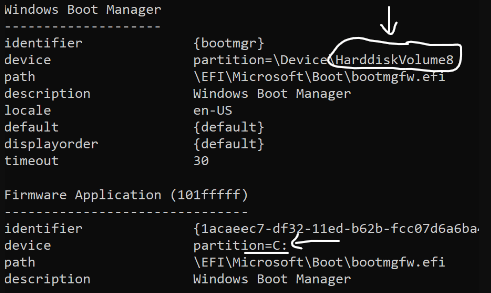

    (3) That BCD /Set command moved {bootmgr} to the top of Displayorder where it does belong. I'm puzzled that it didn't remain there after a reboot.
    (a) Are you sure it was a reboot -- not a shutdown, then boot? Those are normally different.
    (b) I'm thinking (not really sure) you've got two BCDs. One is on HarddiskVolume8 which the {bootmgr} would use. That should be the EFI partition. The other is on C: which the direct boot to C: uses...
    I think HarddiskVolume8 is indeed the EFI partition, otherwise {bootmgr} would also say C: is the device. Let's put a letter on EFI to access its BCD directly. EFI is the FAT32 partition...
    DiskPart <<<Enter DiskPart
    List Vol <<<Show the volume numbers & letters
    Select Vol 7 <<<Focus on EFI -- IF it's still volume 7
    Exit <<<Leave DiskPart
    DIR C:\EFI\Microsoft\Boot\BCD /a <<<Is there one on C?
    DIR S:\EFI\Microsoft\Boot\BCD /a <<<Is there one on S?
    BCDEdit /Store C:\EFI\Microsoft\Boot\BCD /Enum {fwbootmgr} <<Show fwbootmgr
    BCDEdit /Store C:\EFI\Microsoft\Boot\BCD <<<Show the boot manager & loader
    BCDEdit /Store S:\EFI\Microsoft\Boot\BCD /Enum {fwbootmgr}
    Let's do that investigation, then decide how to fix it.
