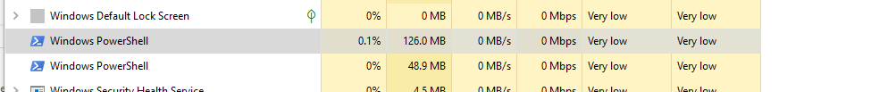

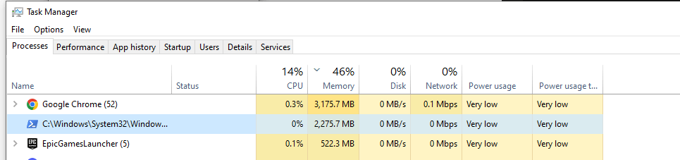

This has been happening for over a week now, whenever I turn on my Pc within 30mins powershell quickly flashes on the desktop and then it appears on task manager as 2-4 process. over time both processes would be using up to 4000mb of memory each. my antivirus scan reported clean, same with windows defender.

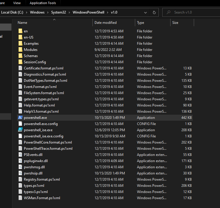

All these process points to the same location in system32 folder.

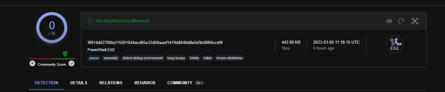

I placed the powershell file on virus total and it also came out clean.
