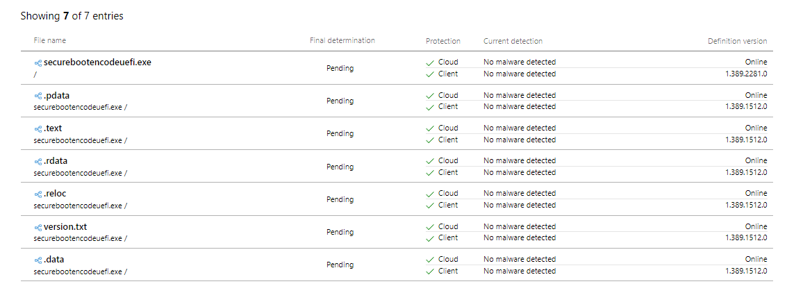

    I submitted the file to Microsoft Security Intelligence and the system didn't find anything suspicious.
    However, the behavior of the executable file is so suspicious that I do not exclude sabotage from within the MS, which is unlikely. Most likely a bug.

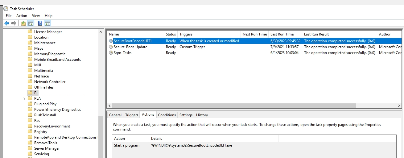

    I found this information useful: https://support.microsoft.com/en-us/topic/kb5025885-how-to-manage-the-windows-boot-manager-revocations-for-secure-boot-changes-associated-with-cve-2023-24932-41a975df-beb2-40c1-99a3-b3ff139f832d
    Secure Boot is recommended by Microsoft to make a safe and trusted path from the Unified Extensible Firmware Interface (UEFI) through the Windows kernel's Trusted Boot sequence. Secure Boot helps prevent bootkit malware in the boot sequence. Disabling Secure Boot puts a device at risk of being infected by a bootkit malware.
    Discussion on reddit: https://www.reddit.com/r/computerviruses/comments/13e9b0s/gathers_encoded_secureboot_uefi_telemetry_in_task/
    Screenshot of task from my server:
