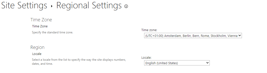

    2024-06-05T13:20:15+00:00
    I might have found a fix, although this does mean the behavior changed at some point.
    Setting the Region>Locale setting to the exact same one as the effected user's machine restores the original desired behavior, both solves the incorrect date selected in calendar ui and sets a default value again.
    In theory the browser should know which locale is set on the machine, so I fail to see why this is a hard failure when there's a mismatch in site settings and locally. Non the less, worth a try if not already checked and it works out in my usecase as we force the locale through AD anyway to be the same everywhere.
  5. Anonymous
    2024-06-05T18:13:18+00:00
    Thank you Nils! Although we already had those time zone settings set correctly under those Regional Settings, going in and re-clicking on them and doing the 'OK' at the bottom does seem to have fixed things, some kind of magic? All I know is that now the day's date/time combo is back to being right on the minute, yes!
