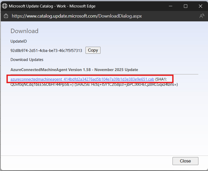

A MUST for me anyway. As you are probably aware if your VMs were/are running the classic VM Insights your VMs are already running the 'AzureMonitorWindowsAgent'.
Here is one thing that definitely was a problem for me. Now keep in mind I could not find any KB or doc stating this is required (thanks Microsoft!) and I found out myself because I was just trying anything - but update the 'AzureMonitorWindowsAgent' extension to at least version 1.38.1.0 (I believe Microsoft just released 1.39.0.0 on or after 11/01/2025). Last week all my VMs and ARC VMs were running version 1.36.x.x and OTel would NOT work until after updating to version 1.38.1.0. NOTE for Linux O/S a version shown might only be v.1.37.x.x so use that, otherwise it will be 1.38.1.0 or newer.

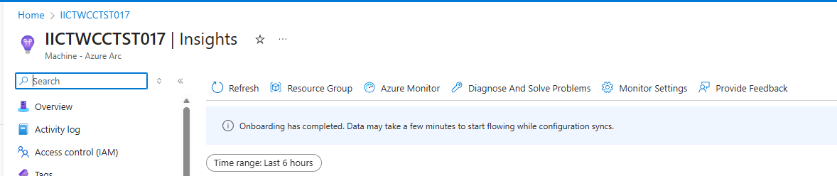

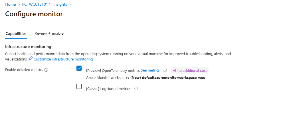

Choose a VM > Insights > select Configure

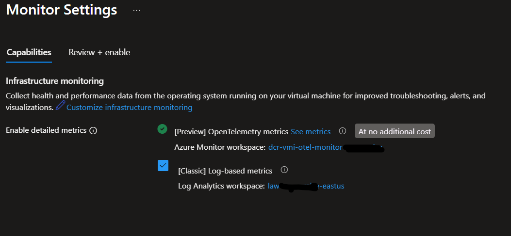

NOTE the two check boxes:
Box 1: Leave the box checked for OpenTelemetry and if you did create a custom AMW it will either already be selected or you can click the drop-down and select the custom AMW. NOTE: in my case since I manually created custom AMWs and deleted all 'Default-VMInsights-<region>-<guid>' my custom AMW is preselected with no drop-down as it’s not needed. If not using a custom AMW then just leave the 'Default-VMInsights-<region>-<guid>' selected.
Box 2: This is a MUST! For classic Insights UNCHECK the box next to Classic log-based metrics. NOTE: OTel will NOT work if the VM is still using Classic log-based metrics. I do not know why that check box is even an option when enabling OTel.
Click Next or Review + Enable
Click Enable

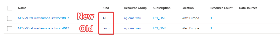

Now the last thing this, so far, ONLY applies to ARC VMs (I’m not sure why). As you know when you enable OTel for a VM and/or ARC VMs it automatically creates a DCR like: 'MSVMOtel-<region>-<vmname>'. This is also where we see ‘Kind’ = Linux even though the O/S is Windows.

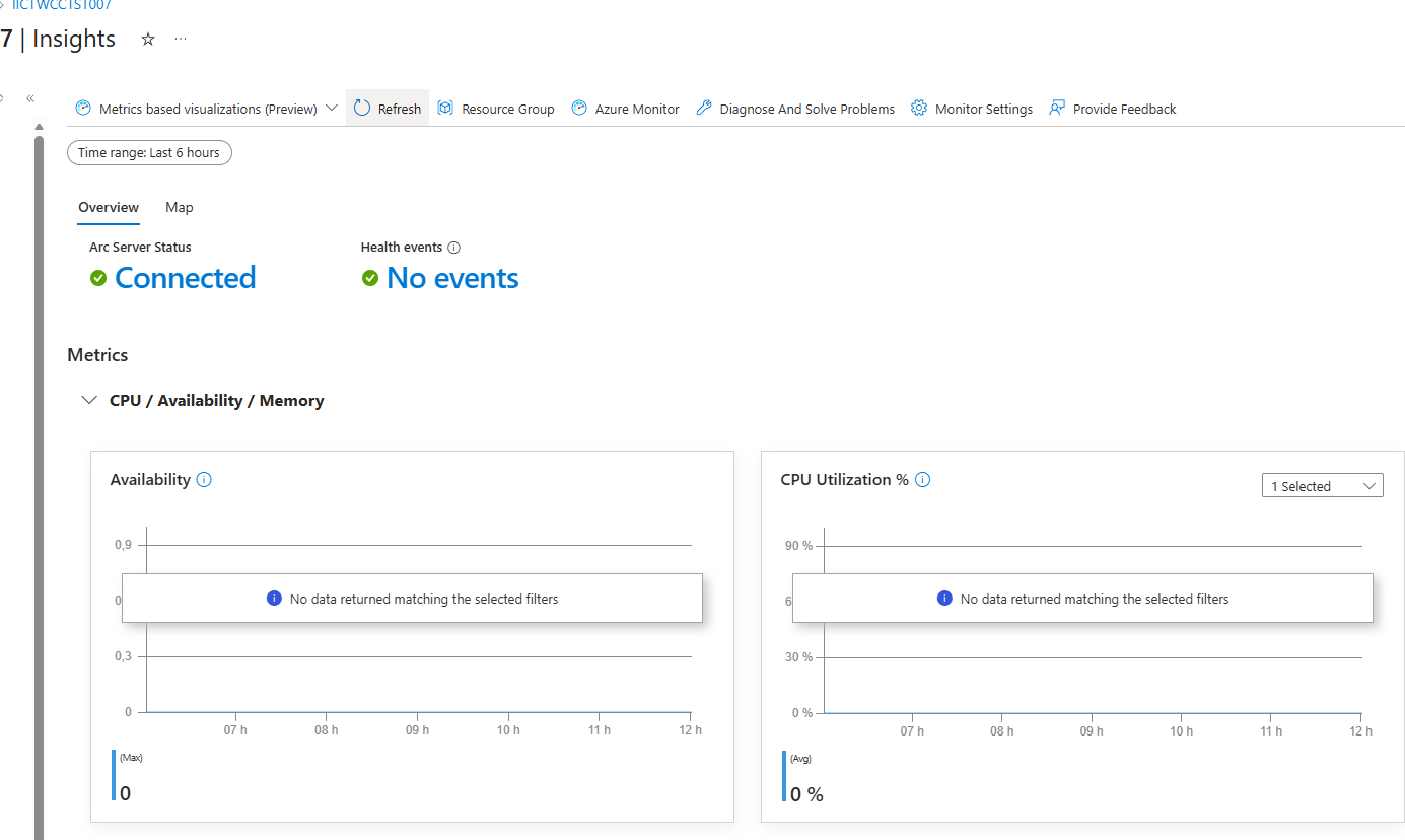

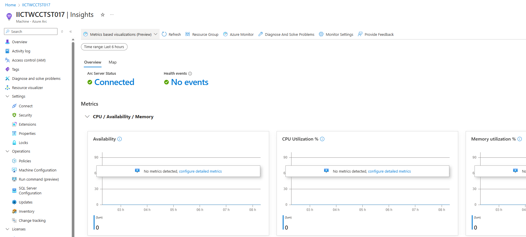

KEEP IN MIND. As I’m sure you know, making changes in Azure like this can be slow when updating at the back-end. And from my experience enabling OTel is no exception. In some cases Azure VMs took up to 30 minutes before data was being ingested. And especially for some of my ARC VMs (mostly because they are really remote) it took an hour before OTel was reporting data. So yeah, there’s that.
