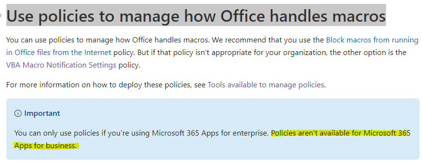

  1. Vivian-HT 17,885 Reputation points Microsoft External Staff Moderator
    2025-10-24T02:27:43.89+00:00
    Dear @LukeMili-1371,
    Thank you for posting your question in the Microsoft Q&A forum.
    If you have Microsoft 365 Apps for Business Premium, Group Policy support is limited to policies for web apps and privacy policies for client apps. Cloud Policy support is limited to policies for web apps. For more, please refer to the Microsoft Official Documents: Office applications service description
    • If devices are running Microsoft 365 Apps for business (the SKU included in Business Premium), several Office policy channels behave differently than Microsoft 365 Apps for enterprise.
    • The Cloud Policy service (config.office.com) roams with the user and overrides Trust Center, but on Apps for business, macro policies aren’t enforced (privacy only). If you need cloud policy to lock macro settings, you’ll want Microsoft 365 Apps for enterprise licenses.
    • For reference: Overview of Cloud Policy service for Microsoft 365
    And for more information about using policies to manage how Office handles macros, please refer to the link: Use policies to manage how Office handles macros.
    Therefore, in the Microsoft Intune admin center, you can use either the Settings catalog (preview) or Administrative Templates to configure and deploy policy settings to your users for devices running Windows 10 or later. It is possible, but there are some important limitations compared to Apps for Enterprise:
    To get started, go to Devices > Configuration profiles > Create profile. For Platform, choose Windows 10 and later and then choose the profile type. For reference: Microsoft Intune admin center
    For more information, see the following articles:
    Limitations:
    • UI may not grey out in Apps for Business even if macros are blocked.
    • Full enforcement (including UI lock) is guaranteed only with Microsoft 365 Apps for Enterprise.
    • Avoid mixing old Administrative Templates with Settings Catalog.
    I hope this information is helpful. Please follow these steps and let me know if it works for you. If not, we can work together to resolve this.
