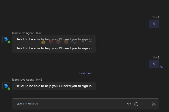

Hi, Hope youre doing well.
I have configured a copilot studio agent with manual authentication settings and connected it to D365 Customer service. I have a SharePoint knowledge base and Live handoff scenario from Teams for the copilot agent; but I'm not able to login or configure SSO.

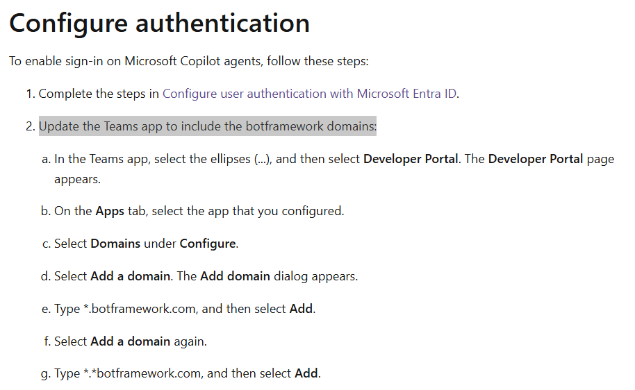

For manual login, the redirect login button does not show up and SSO does not work which is mentioned in a documentation as well. All the steps according to the documentation have been followed and verified.
Please suggest ways to fix this issue
Thank you in advance!

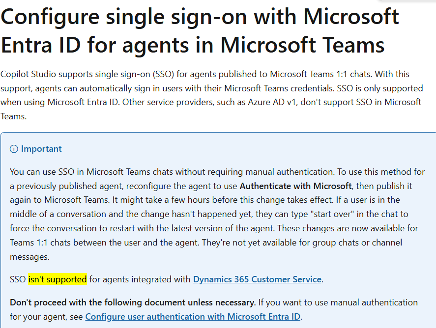

    To enable authentication for your Copilot Studio agent connected to Dynamics 365 Customer Service in the Teams channel, you need to ensure that you are following the correct configuration steps, especially since SSO (Single Sign-On) is not available for agents integrated with Dynamics 365 Customer Service. Here are some suggestions to troubleshoot and fix the issue:
    1. Manual Authentication: Since you have configured manual authentication, ensure that you have followed all the steps correctly. Check if the Require users to sign in option is enabled in the authentication settings.
    2. Redirect URL: Verify that the redirect URL is correctly set in your app registration in the Azure portal. This is crucial for manual login to work.
    3. Client Secret: Ensure that you have generated a client secret and that it is correctly configured in your agent's authentication settings.
    4. Teams Integration: Since SSO is not available for Dynamics 365 Customer Service agents, you may need to rely on manual authentication. Make sure that the manual authentication settings are correctly implemented in your Copilot Studio agent.
    5. Testing: After making changes, test the configuration by publishing the agent again and checking if the redirect login button appears.
    6. Documentation Review: Double-check the documentation for any specific requirements or steps that may have been overlooked.

    I understand you're encountering issues configuring both manual login and single sign-on (SSO) for a Copilot Studio agent integrated with Dynamics 365 Customer Service. Based on preliminary research, I’d like to highlight that in the official Microsoft documentation titled Configure single sign-on with Microsoft Entra ID for agents in Teams, it is explicitly stated:
    This indicates that SSO is currently not supported in this scenario, and manual authentication would be the only viable option.
