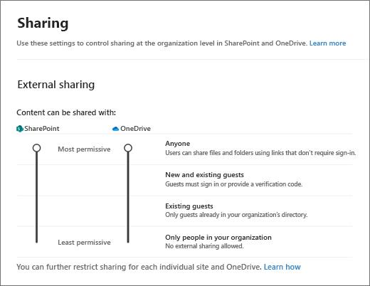

    1. SharePoint tenant and site sharing settings
      • When external sharing is turned off for the entire SharePoint environment, you will not be able to turn it on for specific site collections.
      • Therefore, in SharePoint admin center, confirm external sharing is enabled for the tenant first, then verify the specific site also allows external sharing.
      • User's image
