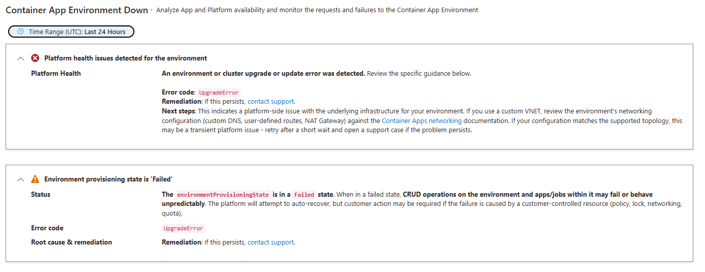

Observing this problem, can't spot anything on our side that could have provoked it, also been around for more than 8 hours now, any ideas on what shall we do?

    Based on the screenshot, this looks like an environment-level infrastructure update failure (UpdateError), rather than a failure of an individual Container App or revision. The diagnostic message also indicates that the platform detected an environment/cluster upgrade or update error.

    Review properties.provisioningState and the environment configuration. Also check Activity Log around the time the failure started for Microsoft.App/managedEnvironments operations and any additional error details. The API exposes detailed error information such as code, message, details, and innererror when available.
    If there were no customer-side networking, policy, or environment changes and the state remains Failed, I wouldn't recommend deleting/recreating the environment yet, especially if it hosts production workloads. At that point this could require Azure Container Apps platform-side investigation, and opening an Azure Support request with the environment resource ID, region, timestamp when the issue began, and relevant Activity Log correlation IDs would be appropriate.
