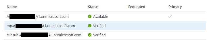

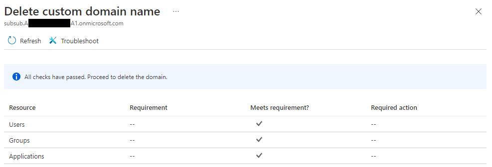

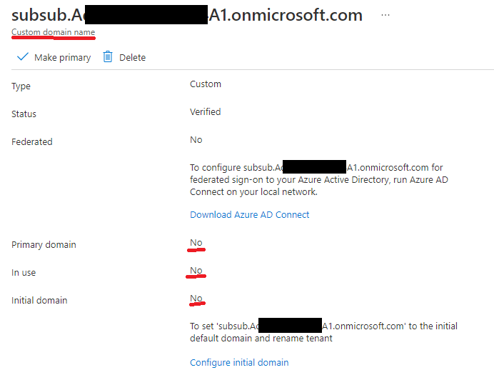

  5. Patrick-L 0 Reputation points
    2023-02-15T08:07:36.2966667+00:00
    Hi all,
    I'm facing the same issue.
    I created two sub-domains on my default "onmicrosoft.com" address:User's image
    Even the sub-domains aren't set as "Primary", I'm not able to delete one of them:
    "subsub.xxx.onmicrosoft.com" is a custom domain with state: "Verified" but not the "Primary" domain:
    Also deleting this Domain my Power-Shell with: Remove-AzureADDomain -Name subsub.AxxxxxxxxxxxA1.onmicrosoft.com was not possible.
    What am I doing wrong?
    Is this a Azure-Bug?
    How to proceed here?
