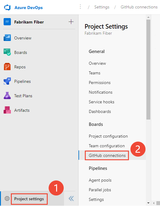

Open Project Settings>GitHub Connections.
  1. Sign into Azure Boards for the project you want to connect to GitHub repositories.
  2. Choose (1) Project Settings> (2) GitHub connections.
    Screenshot of open Project Settings>GitHub connections.

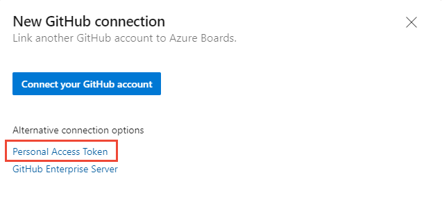

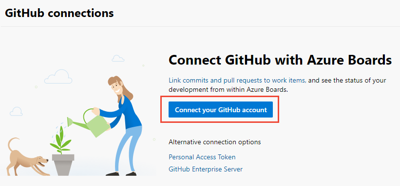

  3. If it's the first time making a connection from the project, choose Connect your GitHub account to use your GitHub account credentials.
    Screenshot of first time connecting with GitHub credentials.
    Otherwise, choose New connection, and select your authentication method from the New Connection dialog.
    When you connect using your GitHub account, use your GitHub account credentials to authenticate. If connecting using PAT, see Add a GitHub connection using PAT. If connecting to a GitHub Enterprise Server, see Register Azure DevOps in GitHub as an OAuth App.

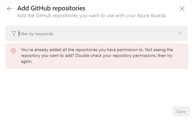

    If all repositories have been connected already to the current or other organization, then the following message displays.
    Screenshot of message where no more repositories exist to connect.

  1. To choose a PAT when connecting a GitHub repository, choose Personal Access Token when making a first-time connection.
    First connection, choose Personal Access Token.
    Or, from the New GitHub connection dialog.
    New GitHub connection dialog, choose Personal Access Token.

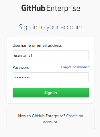

  1. Sign into the web portal for your GitHub Enterprise server.
    Sign into GitHub Enterprise server

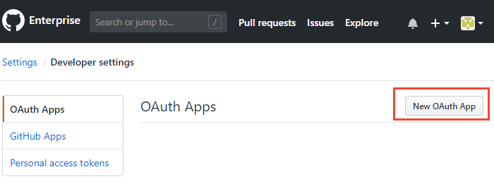

  2. Open Settings>Developer settings>Oauth Apps and choose New OAuth App.

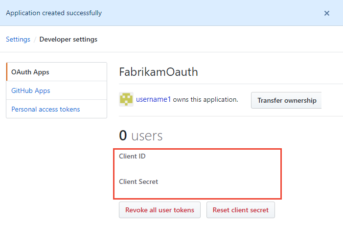

  5. Upon success, you'll see a page that provides the Client ID and Client Secret for your registered OAuth application.

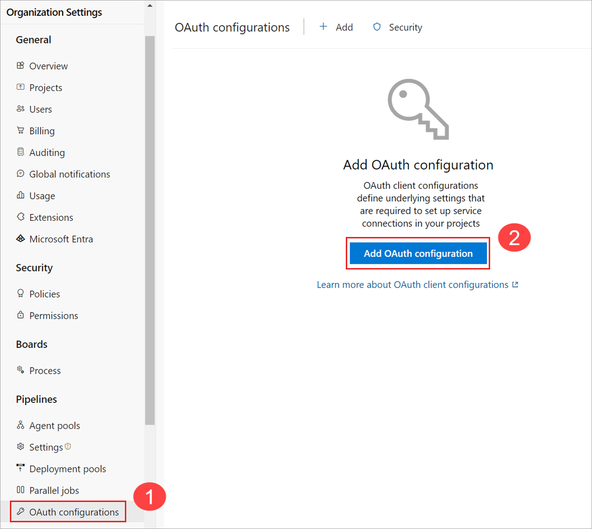

Register your OAuth configuration in Azure DevOps Services
  1. Sign into the web portal for Azure DevOps Services.
  2. Add the GitHub Enterprise Oauth configuration to your organization.
  3. Open Organization settings>Oauth configurations, and then choose Add Oauth configuration.
    Open Organization Settings, OAuth configurations.

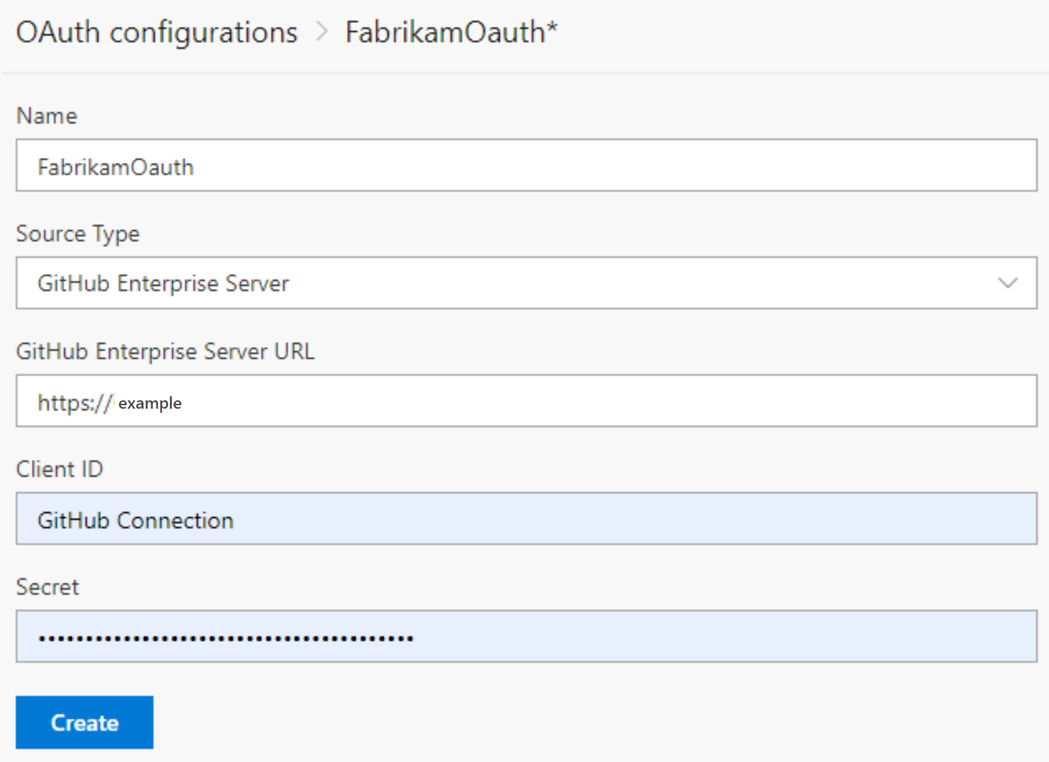

  4. Fill in the form that appears, and then choose Create.
    OAuth configurations dialog.

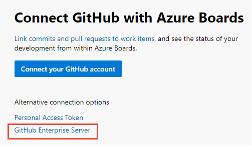

  1. From the Project Settings>GitHub connections page choose GitHub Enterprise Server, choose GitHub Enterprise Server when making a first-ptime connection.
    First connection, choose GitHub Enterprise Server.
    Or, from the New GitHub connection dialog, choose GitHub Enterprise Server.

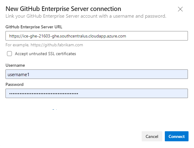

    Connect using a Username and Password
    Enter the URL for your GitHub Enterprise server and the administrator account credentials recognized by that server. And then choose Connect.
    New GitHub Enterprise connection, User Name connection dialog

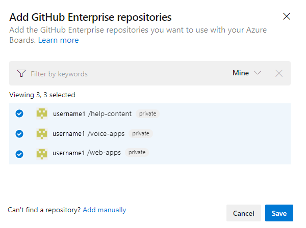

    Choose the repositories to connect to
  3. The dialog lists all repositories for which you have GitHub administration rights. You can toggle between Mine and All to determine if others appear, and then check the ones that you want to add. Choose Save when done.
    Choose repositories to add.
