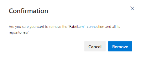

  1. From your project in Azure DevOps, go to Project settings > GitHub connections.
  2. To add or remove repositories, select the More options ellipses for the connection and choose Add repositories or Remove repositories from the menu.
    Screenshot shows the GitHub connection menu of More options.
  3. To remove all repositories and the connection, choose the Remove connection option. Then, choose Remove to confirm.
    Screenshot shows the confirmation removal of GitHub connection.
