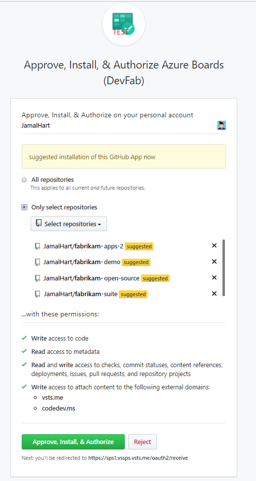

Confirm the connection
Review the GitHub page that displays and then choose Approve, Install, & Authorize.
Provide your GitHub password to confirm.
When you're done, you should see the new connection with the selected repositories listed.
