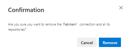

If you encounter a problem with a connection, we recommend that you remove the connection and start over with a new connection.
From your project in Azure DevOps, go to Project settings > GitHub connections.
To add or remove repositories, select the More options ellipses for the connection and choose Add repositories or Remove repositories from the menu.
To remove all repositories and the connection, choose the Remove connection option. Then, choose Remove to confirm.

If you uninstall the Azure Boards app for GitHub, the following message displays in Azure Boards, Project settings > GitHub connections. Choose Remove connection to remove all previously made GitHub connections. For more information, see Add or remove GitHub repositories.
