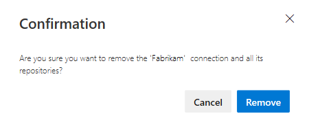

  3. To remove all repositories and the connection, choose the Remove connection option. Then, choose Remove to confirm.
