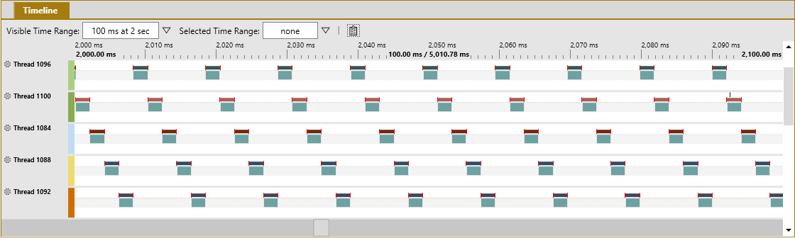

PIX
Figure 1 shows what the stair-step effect looks like in a PIX timeline.
Figure 1. Stair-step pattern in thread timelines in a PIX Timing Capture
Screenshot of a stair-step pattern in thread timelines in a PIX Timing Capture
If your title has code that spins waiting for work, or if it attempts to acquire a lock on a portion of code needed for work, it can be useful to add PIX events around the spin and acquire portions. Adding these events can help you quickly identify thread behavior and searching for these events in PIX can help you identify when too much time is spent waiting. For more information about the spinning case, see Core utilization: spinning.

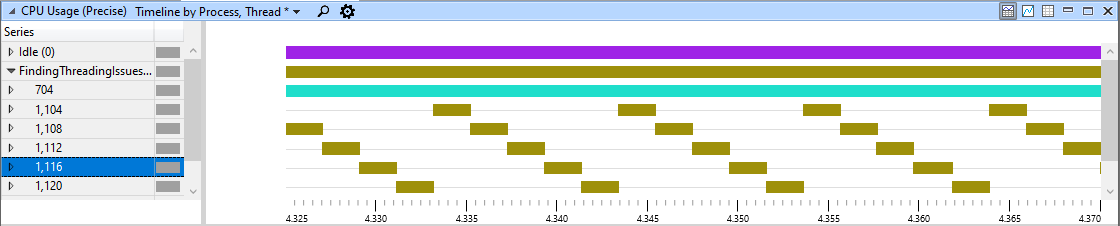

Windows Performance Analyzer (WPA)
Figure 2 shows what it looks like when threads don't run in parallel.
Figure 2. Timeline by Process, Thread window that shows a stair-step effect where threads aren't running in parallel
Screenshot of a Timeline by Process, Thread window that shows a stair-step effect where threads aren't running in parallel

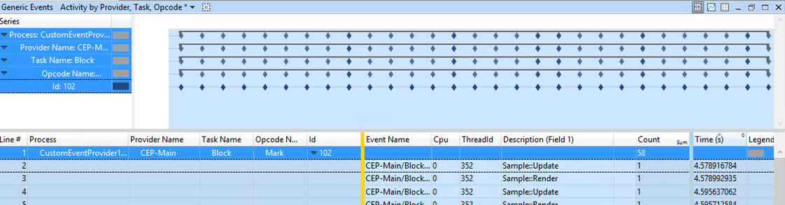

If your title has worker threads that spin while they're looking for work, you'll find it useful to add an Event Tracing for Windows (ETW) event. For an example, see figure 3. For details about adding ETWs, see the CustomEventProvider Sample. To download (Microsoft Game Development Kit (GDK) samples, see Xbox Developer Downloads). You should add events around the spinning block and processing blocks on the worker thread. The Generic Events Activity by Provider, Task, Opcode window in WPA shows when each event fires. To identify threads that are spinning excessively, see Core utilization: spinning.
Figure 3. Generic Events window that shows custom ETW events from the CustomEventProvider sample
Screenshot of a generic Events window that shows custom ETW events from the CustomEventProvider sample
