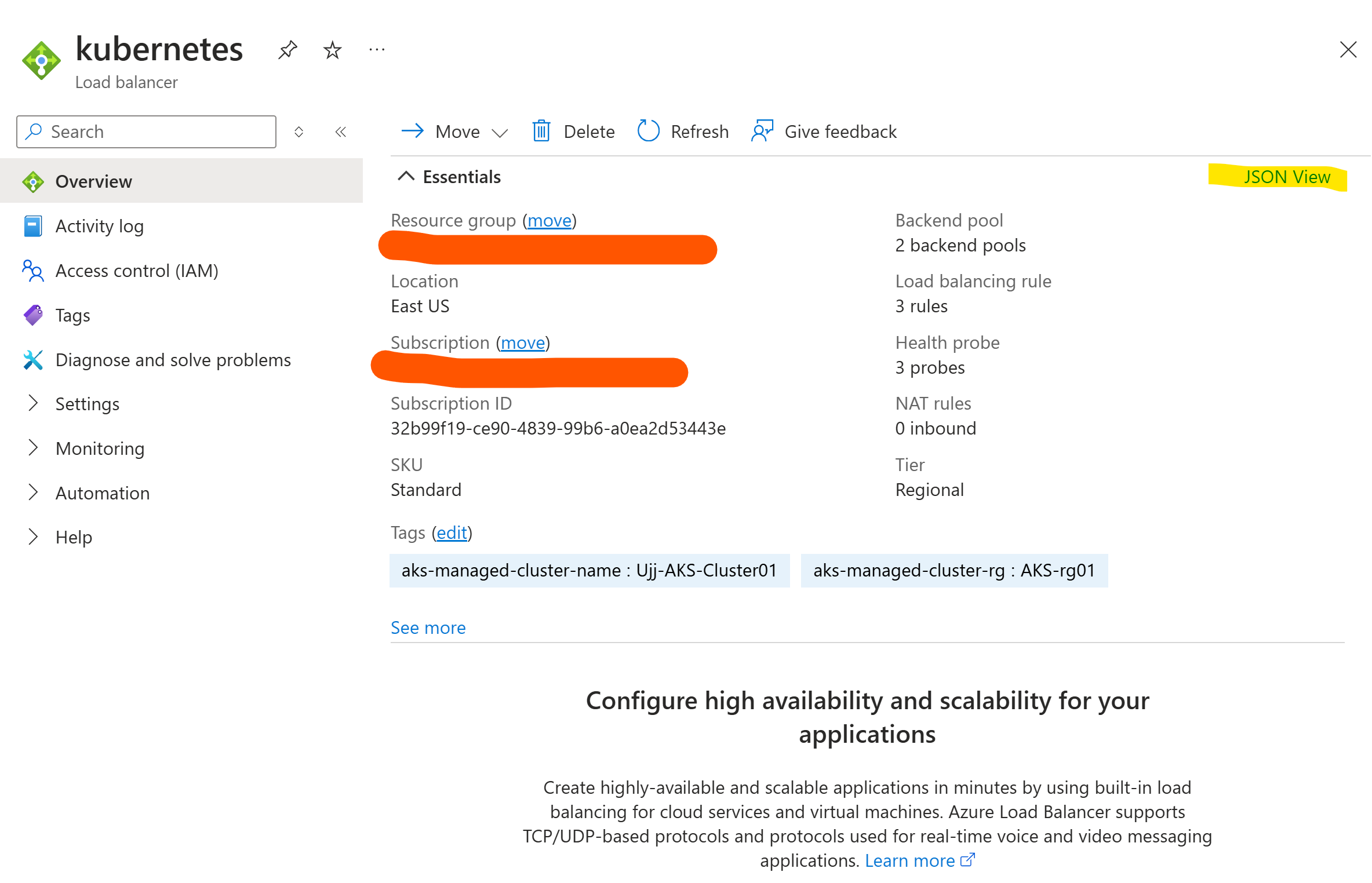

    I understand that extracting this information from the portal could be challenging, however we may extract this information from the Json configuration of the Azure load balancer and using Powershell on the JSON output.
    • First to load the configuration of the Azure Load balancer go to Loadbalancer on Azure Portal and load the JSON View as shown below
    • Once JSON configuration is loaded, save the configuration and assign it to a JSON Variable $jsonConfig.
