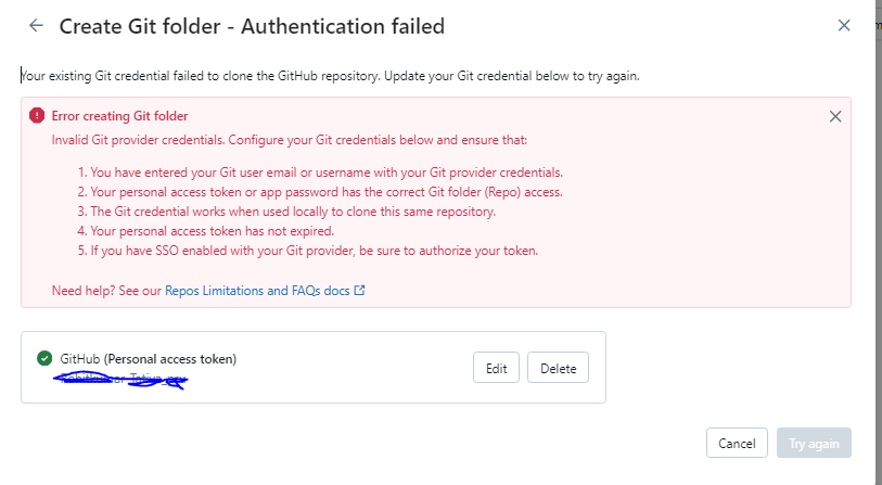

I am having DevOps configured with Azure databricks but now we are migrating from DevOps to Github Enterprise. To point our Azure databricks with Github enterprise repository from Azure databricks workspace post linking the Github encounter the below error:
I have ensure that
  1. PAT token is classic and has access to Repo.
  2. Valid user name or email
  3. Expiry is in next few months so no issues.
  4. SSO authorization is done for the Github organization.

    It seems like you are encountering an error while linking your Azure Databricks workspace with your Github Enterprise repository. The error message suggests that there might be an issue with your Git credentials.
    You have mentioned that you have already ensured that your personal access token (PAT) has the correct Git folder (Repo) access, valid user name or email, and has not expired. You have also authorized your token for SSO with your Github organization.
    However, the error message also suggests that you need to ensure that your Git credential works when used locally to clone the same repository. Have you tried cloning the repository locally using the same Git credential? If not, I would suggest you try that and see if it works.

    @Rohitkumar Tatiya - I'm glad that you were able to resolve your issue and thank you for posting your solution so that others experiencing the same thing can easily reference this! Since the Microsoft Q&A community has a policy that "The question author cannot accept their own answer. They can only accept answers by others ", I'll repost your solution in case you'd like to accept the answer .
    Ask: Azure databricks integration with Github Enterprise
    Solution: The issue is resolved. The problem after ensuring all five things are okay was at network level. We have identified the two solution outof which configuring the proxy git server we are able to integrate the azure databricks with the github.
    The two solutions were identified as below:
    1. whitelist the Azure databricks control plane Ips at GHE organization security settings with “Allow IP list”. Reference: Managing allowed IP addresses for your organization - GitHub Enterprise Cloud Docs
    2. configure the git proxy, this way the traffic will go through VNet: Set up private Git connectivity for Azure Databricks Git folders (Repos)
