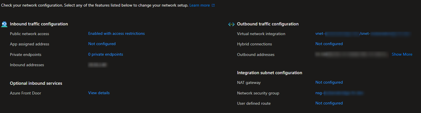

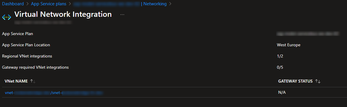

  2. Schneider, Michael 65 Reputation points
    2024-04-04T09:56:14.7133333+00:00
    Hi @Silvia Wibowo I tested it out by creating a complete new ASP P1v3 with my Azure Functions and it looks exactly like before with B1. See Network Settings in ASP: User's image
    Azure Functions Network Settings:User's image
    So, is it just something running in the background that I can't see? How can I identify a valid configuration for ASP.NET and Azure Functions with a VNet? And my second question goes back to the Service Bus (Standard).
    With the current configuration, ASP P1v3, the function is unable to communicate with the Service Bus if the network rules are configured to block public network access but allow TrustedServiceAccessEnabled. If I enable public network access and set the Default Action to Deny, I have to add the Azure Functions' Outbound IPs to the Allow List to get it up and running again. However, it doesn't seem like it is running through the VNet. So I wonder if i have a problem with my vnet integration of the ASP and Function or if there is any limitation to Service Bus Standard with Trusted Service Azure Functions in ASP.
