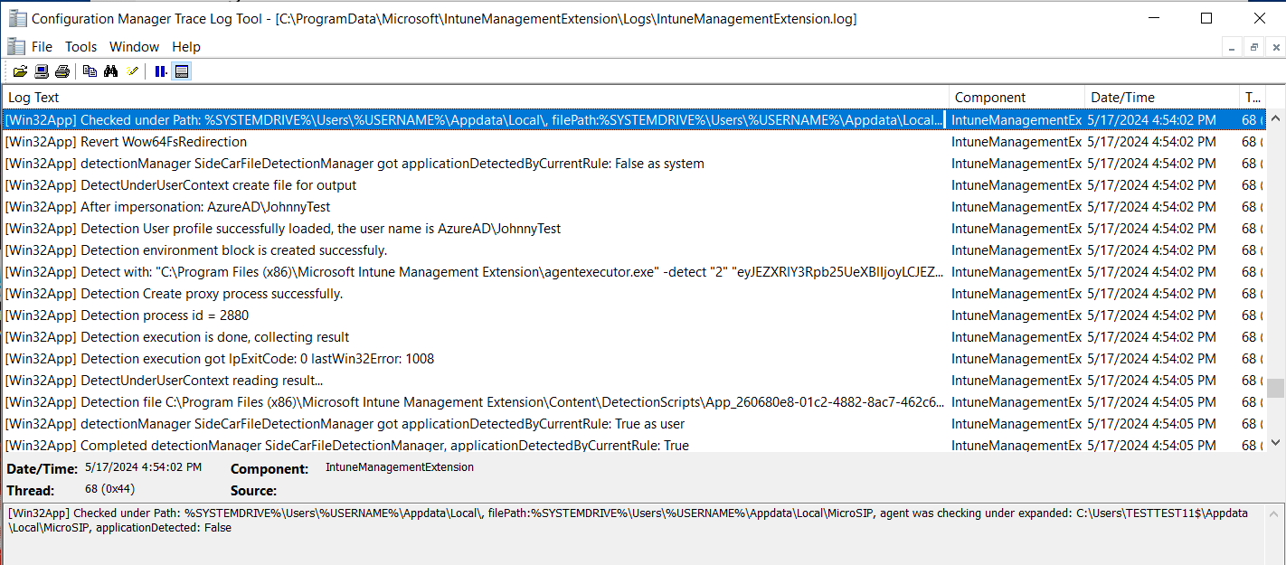

I am trying to uninstall a application called MicroSIP via Microsoft Intune on all of our Windows machines but the script is says "not installed" every time I run it. I have tied multiple scripts but no luck. I did find my issue. So here it is. Every time the script rans it looks under C:\Users for the name of the MACHINE instead of the USER when expanding %USERNAME%. I have not idea what I am doing wrong

    You are putting the full path to the executable into the MicroSIPUninstallPath variable, so there no need to reference %username%. There is also no need to call cmd.exe as Powershell can just run the program directly.
    The main problem that you have is how the application's installer functions. If it installs on a per user basis, then it will likely save registry keys into HKEY_CURRENT_USER. If Intune is running your script as the SYSTEM account, then uninstall.exe is not going to find any registry entries and is going to fail. If it just looks to .INI or other config files, then that should work, but when you launch the uninstall.exe you may need to set the working directory to the directory where those files are located.
    In addition to the "/S" switch, you should investigate the switch that generates a log file. That way if uninstall.exe does not work, you can look to its log file to see what it did not like.
