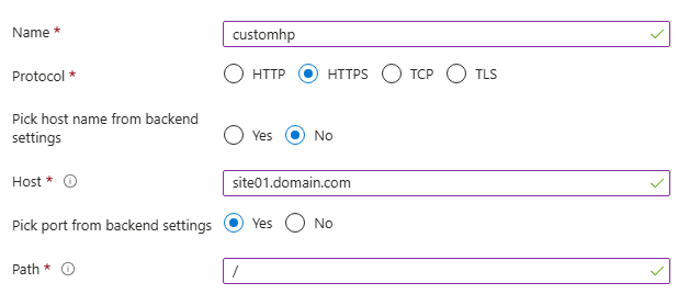

    If all the above checks out, then try to setup the custom health probe as below and try again:
    And set "override hostname" in the Backend Setting to NO.
    Refer: https://learn.microsoft.com/en-us/azure/application-gateway/application-gateway-probe-overview#some-use-cases-for-custom-probes

    1. The second solution is the one I shared above.
    When a backend server has a wildcard certificate (*.contoso.com) installed to serve different sub-domains, you can use a Custom probe with a specific hostname (required for SNI) that is accepted to establish a successful TLS probe and report that server as healthy. With "override hostname" in the Backend Setting set to NO, the different incoming hostnames (subdomains) will be passed as is to the backend.

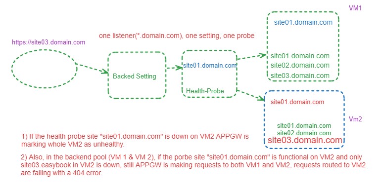

    The following works, but for each site, we need specific settings and probes, and we have over 150 HTTPS sites, with a limit of 100 backend settings and health probes in APPGW. <---- You don't have to add custom health probe for each sub-domain. You can create a single custom health probe with site01.domain.com and associate it to the single wildcard listener and backend setting and this should work.
    This is mentioned in the below document:
    For backend health check, you can't associate multiple custom probes per HTTP settings. Instead, you can probe one of the websites at the backend or use "127.0.0.1" to probe the localhost of the backend server. However, when you're using wildcard or multiple host names in a listener, the requests for all the specified domain patterns are routed to the backend pool depending on the rule type (basic or path-based).
    Refer: https://learn.microsoft.com/en-us/azure/application-gateway/multiple-site-overview#considerations-and-limitations-of-using-wildcard-or-multiple-host-names-in-a-listener
