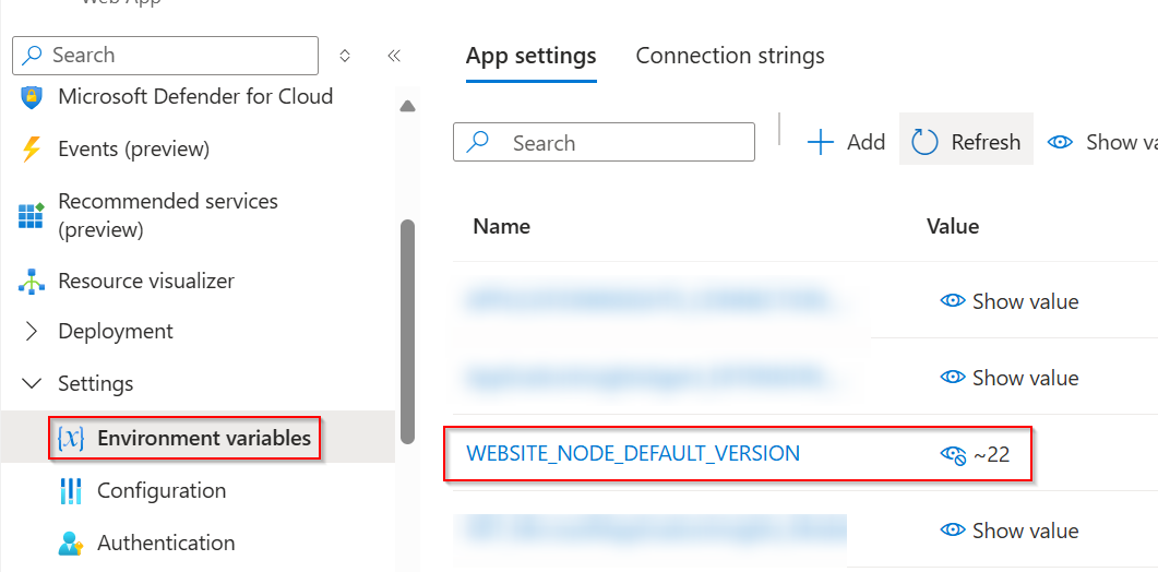

I created a new web app and still the same. Instances

2025-05-16T16:11:55.340132008Z ❌ Failed to load ./routes: ReferenceError: ReadableStream is not defined
2025-05-16T16:11:55.340194509Z at Object.<anonymous> (/node_modules/undici/lib/web/fetch/response.js:528:3)
