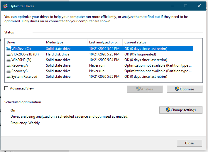

First noticed this in my main system last week running 20H2 (non-insider). Disk Optimization is not running automatically, had about 13 days showing last run, settings are at default to run weekly. Did a manual run back last week.
This snapshot is from a virtual machine 20H2 that I test software on daily. Both devices are kept current with builds.
This snapshot is from my main system today. Have to give it couple more days to verify and will file a FBH report at that time and update this thread. Please advise if there is anything else I can add with FBH report.

    Hi Eddie, hope you had a great long weekend.
    There is an issue regarding Disk Optimization not running properly in VMware. The Host is on SSD, the Guest is on HDD. Had to resort to a snapshot over month old, thus the 09/16 start date which was run manually.
    According to Task Scheduler, the Scheduled Defrag did run 10/25. Optimize Drives does reflect this on the System Reserved partition but not the C:Drive itself.
    Feedback Hub Link via VM: https://aka.ms/AAa3662

    Another day, no change with Disk Optimization:
    FBH link:  https://aka.ms/AA9zxhw
    Johnny,
    On this feedback, both the event log and defrag status in the registry indicate the UI is displaying correctly.
    • Full defragmentation was run on Volumes D:, E:, F: and G: on 2020/10/11
    • Retrim was run on C: and 'System Reserved' volumes on 2020/10/06
    • Full defragmentation was run on C: and 'System Reserved' volumes on 2020/09/25
    So while nothing is broken, I think I see your concern here. I can see the confusion between the what is happening and what the UI is displaying. Part of this is full understanding of the optimization process. I agree the UI could probably use some clarification. I've taken this back to the feature team for discussion. Please understand that this does not mean any changes will occur around this, and if they do, it will be some time.

    Hi Eddie,
    Thanks again for the explanation regarding concern over SSD drives. I read the updated link you provided regarding disk defrag and that explains the concern regarding scheduling on SSD. Was aware of the HDD being defragged on schedule, the Trim that was run on 10/06 was done manually.
    Normally never see this. Guess it's the old school in me, anytime I install any programs, update, etc., run Disk Cleanup and then Optimize (Trim) the C:drive. Hard to shake old habits from Dos days  :-)
    If I understand this correctly, does Optimization only trim once per 30 days or is it actually going to do a defrag (continuous files). That part was really not clear:
