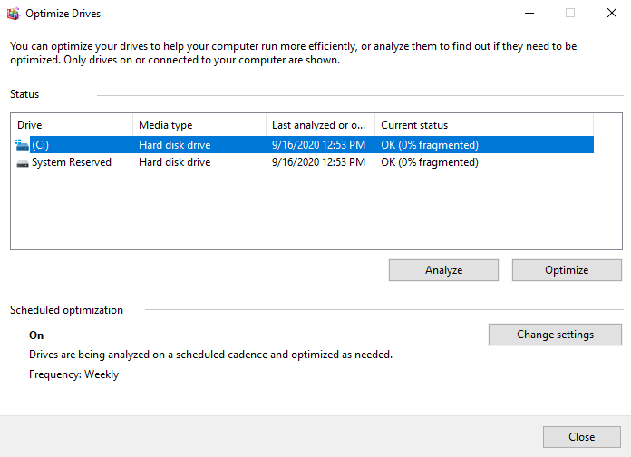

First noticed this in my main system last week running 20H2 (non-insider). Disk Optimization is not running automatically, had about 13 days showing last run, settings are at default to run weekly. Did a manual run back last week.
This snapshot is from a virtual machine 20H2 that I test software on daily. Both devices are kept current with builds.
This snapshot is from my main system today. Have to give it couple more days to verify and will file a FBH report at that time and update this thread. Please advise if there is anything else I can add with FBH report.

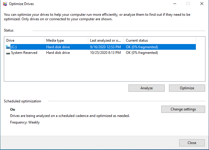

    There is an issue regarding Disk Optimization not running properly in VMware. The Host is on SSD, the Guest is on HDD. Had to resort to a snapshot over month old, thus the 09/16 start date which was run manually.

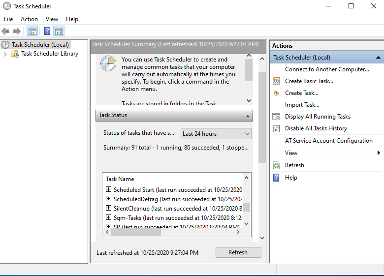

    According to Task Scheduler, the Scheduled Defrag did run 10/25. Optimize Drives does reflect this on the System Reserved partition but not the C:Drive itself.

    Procedure for clarity:
    -Base snapshot 19042.508 offline, first step enabled Task Scheduler history
    -updated Net, Flash via msu file
    -updated via dism CU kb4580364 to 19042.608
    -put online, updated Windows Security definitions and 33 Store Apps
    -signed in, joined Insider Beta channel
    -10 more Store apps updated
    Pictures provided are from offline stage, no change online.
    Ran Windows Security quick scan, Storage Sense with no manual Optimization. Saved snapshot.

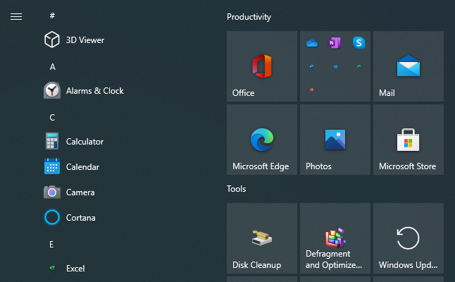

    Apologize for going off topic, the Insider team needs to sit down with the Edge team regarding tiny office web apps. This has progressed from Dev channel right down to current Release 20H2.
    Icons are normal up to opening Edge C. They shrink instantly..
    Regards,
