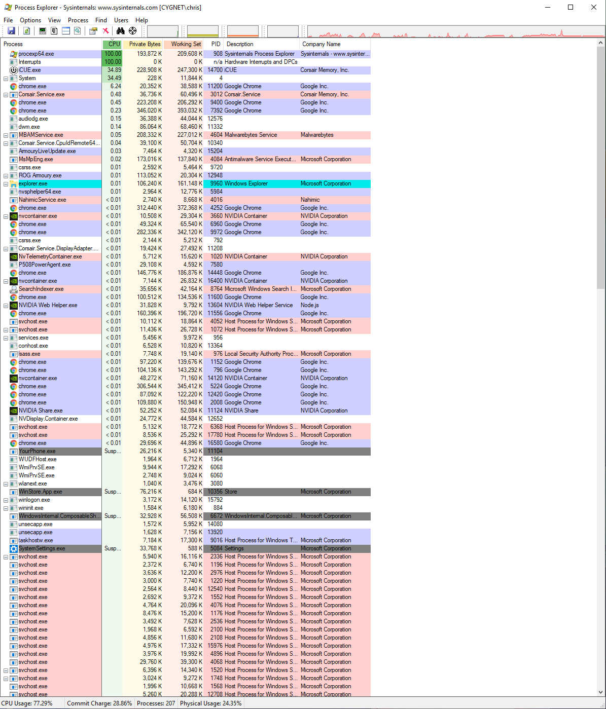

So for roughly the past couple of weeks, I have been having issues with task manager giving me incorrect readings on the CPU usage. Before noticing this issue, I have been running my 9900K at 4.8 GHz all core with an AVX offset of 1. Initially, reducing my clock speed by 100 MHz down to 4.7 GHz all core (AVX offset 0) solved the problem for a couple of weeks, but the problem has now resurfaced despite the CPU literally running at specified stock speeds.
The Task Manager program is incorrectly reporting CPU usage spiking up to 100% at times, sometimes accompanied by the display turning into a black screen for a half-second while playing SCP: Secret Laboratory. Meanwhile, other programs that were running at the time such as Google Chrome or DIscord turn into black windows and require restarting. Other programs such as HWiNFO64, Corsair iCUE, and Process Explorer are reporting much lower CPU usage percentages.

This was taken while running a game (SCP: Secret Laboratory, SCPSL.exe). Something seems off with the process explorer too since the game should be the highest in CPU usage, and the CPU use of the processes don't add up to 100%. I have seen this occur when the computer freezes for a half-second for no apparent reason.
This was also taken while running the same game mentioned above, except this time only the Task Manager is reporting an incorrect CPU usage while Process Explorer says otherwise.
This image shows Task Manager claiming that the CPU frequency is being throttled to 3.6 GHz. CPU-Z is reporting a clock speed of about 4.7 GHz. Task Manager also seems to think CPUs #8 and #9 (starting from #0) are going crazy. I've checked both CPUs in HWiNFO64 and Process Explorer and found nothing wrong with them.
This image is another example of incorrect CPU usage where the actual CPU usage is much less than 50%.

    I feel that there is also a possibility this problem may be unique to my computer**.** The following Process Explorer screenshot shows what happens at around the time my computer freezes for a split-second. There are multiple processes that claim to be using a high percentage of CPU, and they all add up to far more than 100%.
    Either there is something wrong with my hardware, or Windows is having problems allocating CPU time for processes.
    I have seen up to 6 or 7 processes at 100% on Process Explorer for a split-second before.
