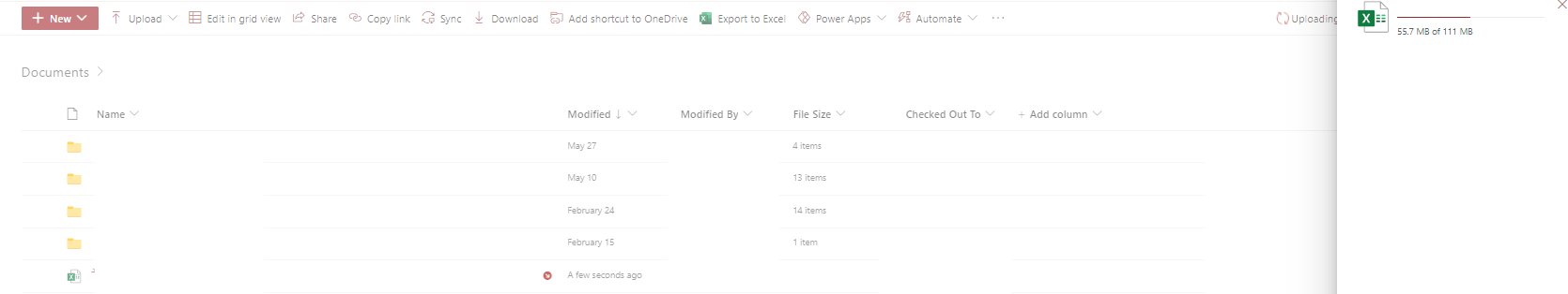

Am attempting to upload files to SharePoint of several clients.
Upload begins normally. After 2 - 4 mb of data transferred upload resets to 0 and begins again.
Upload continues normally until half of file is uploaded (eg 21.2mb of 42.4mb file)
Upload stops.
Approx. 5 minutes later error message "error in the application" appears.
Upload stopped.
File is displayed in SharePoint folder, but contains no data.
