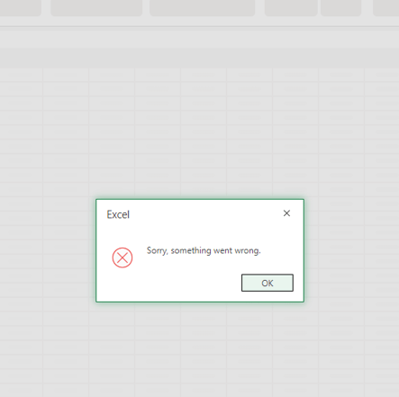

Hello,
What does this type of error mean (photo below)? And how do I resolve it? I don't have much technical background in codes and the likes. But this error appears after I hit "Find Next" / "Find All" in an attempt to search for a specific data around the sheet. Also, it only appears when the data I search is surely on the sheet. But if not on the sheet, it will return the usual "could not find...". It's getting more frequent this week. Hope it does not worsen. Btw, I'm using the web app because sometimes we collaborate as a team and editing via desktop app is not our best option.
P.S. sometimes the error goes away on its own after a few mins of not using the sheet although left open.. But it does not give the confidence that the sheet I'm working on is already okay and working.
Hope to get some answers / advice.
Thanks,
Fam

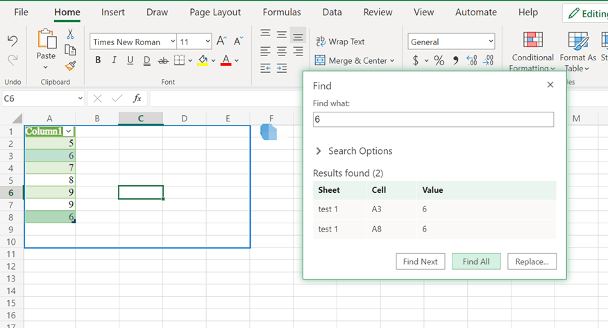

    Since you mentioned that the sheet includes the Power Query, so we did a test in our end >create a workbook with the power query>then open the file in Excel for web>then use the Find function and we can find the data what we wanted without error as the screenshot below:
    We suggest you try to create a new sheet without power Query and  then to check the result. (This way can help us narrow down if the issue was related to the Power Query)
    Meanwhile, can you try to copy the whole content to another workbook to see if the issue will happen again?
