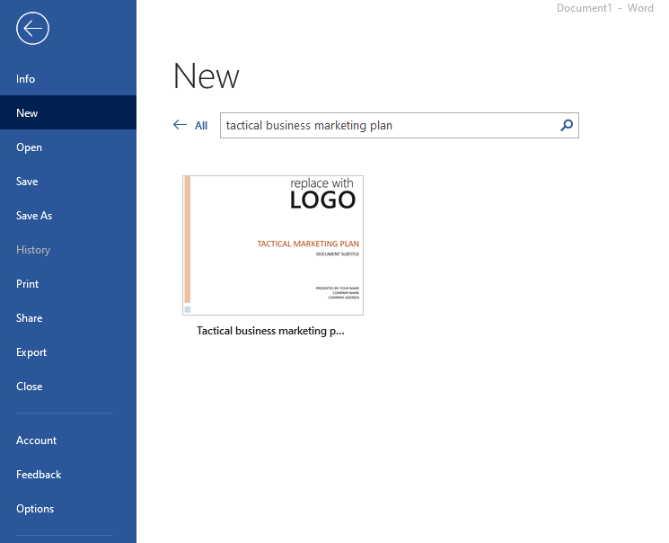

There is a template in Microsoft Word called "tactical business marketing plan". On the last page of the template, there is a table. I would appreciate it if anyone can please explain how the gap is created between the columns. Thanks!

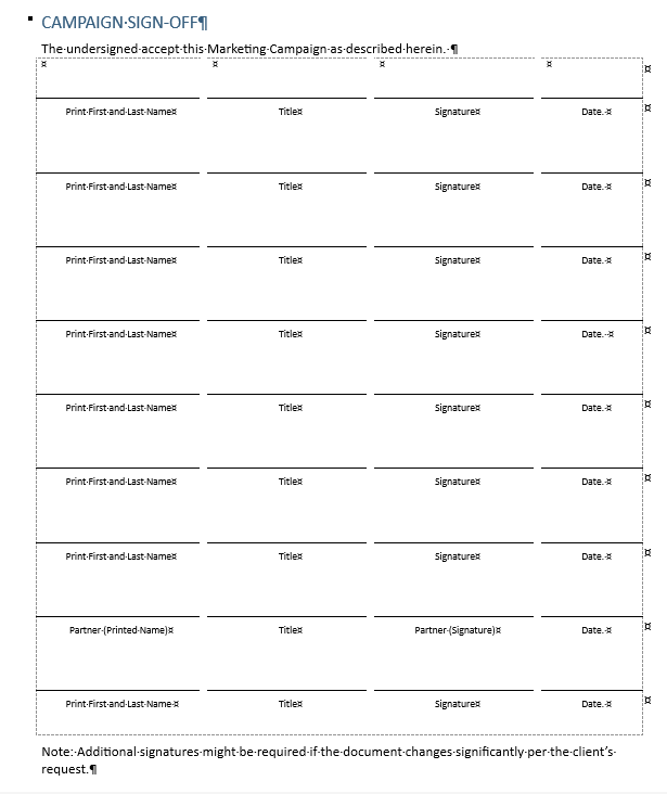

    It seems I could not explain my question with clarity. The solution you provided creates a gap around table cells. Following is an image from a Microsoft template "Tactical business marketing plan" and the table is obviously not created using "Allow spacing between cells" option. I have been formatting documents in Word for decades this looks like something new and interesting to me. Any help is gratefully appreciated.
    2023-03-10T10:12:29+00:00
    Thanks, Anna. Here is another screenshot. If you could review the template, it might be helpful to understand. Thank you very much!

    Check the values for left and right cell margins. Also, investigate if this could be caused by the distance between text and border lines (assuming that the borders have been applied to text paragraphs in the cells and not to the cells themselves).
