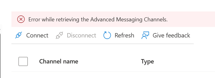

Error creating channel in advanced messaging
I cannot create a channel in advanced messaging and I'm not able to configure WhatsApp communication service. In attach the error messages.

Thank you for reaching us. The error message you’re seeing (“Error while retrieving the Advanced Messaging Channels” with a renderComponentIntoRoot failure) usually indicates a portal blade rendering issue or a WhatsApp Business Account (WABA) onboarding state that is preventing channel creation. We’ll guide you through the steps to resolve this.

Yves Blancquaert • 0 Reputation points2025-11-12T13:04:05.6833333+00:00 Hi,
I've tried everything you proposed but without success. I keep getting the same error messages.

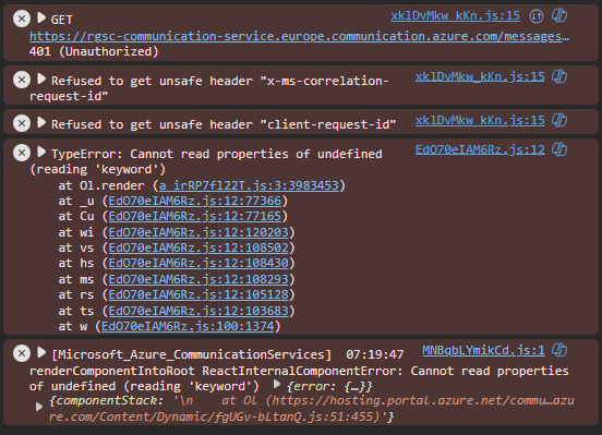

- { "shellProps": { "sessionId": "9695269784c34fbeb8a0ca98d61a2707", "extName": "Microsoft_Azure_CommunicationServices", "contentName": "WhatsAppSandboxOverview.ReactView" }, "error": { "message": "The renderComponentIntoRoot component encountered an error while loading.", "metadata": { "area": "renderComponentIntoRoot" }, "error": { "data": { "message": "The renderComponentIntoRoot component encountered an error while loading.", "metadata": { "area": "renderComponentIntoRoot" }, "capturedErrors": [ { "message": "Error caught in error boundary", "metadata": { "area": "renderComponentIntoRoot", "error": { "stack": "TypeError: Cannot read properties of undefined (reading 'keyword')\n at Ol.render (https://hosting.portal.azure.net/communicationservices/Content/Dynamic/a_irRP7fl22T.js:3:3983453)\n at _u (https://portal.azure.com/Content/Dynamic/EdO70eIAM6Rz.js:12:77366)\n at Cu (https://portal.azure.com/Content/Dynamic/EdO70eIAM6Rz.js:12:77165)\n at wi (https://portal.azure.com/Content/Dynamic/EdO70eIAM6Rz.js:12:120203)\n at vs (https://portal.azure.com/Content/Dynamic/EdO70eIAM6Rz.js:12:108502)\n at hs (https://portal.azure.com/Content/Dynamic/EdO70eIAM6Rz.js:12:108430)\n at ms (https://portal.azure.com/Content/Dynamic/EdO70eIAM6Rz.js:12:108293)\n at rs (https://portal.azure.com/Content/Dynamic/EdO70eIAM6Rz.js:12:105128)\n at ts (https://portal.azure.com/Content/Dynamic/EdO70eIAM6Rz.js:12:103683)\n at w (https://portal.azure.com/Content/Dynamic/EdO70eIAM6Rz.js:100:1374)", "message": "Cannot read properties of undefined (reading 'keyword')", "name": "TypeError" }, "errorInfo": { "componentStack": "\n at Ol (https://hosting.portal.azure.net/communicationservices/Content/Dynamic/a_irRP7fl22T.js:3:3979839)\n at s (https://portal.azure.com/Content/Dynamic/xklDvMkw_kKn.js:19:1836)\n at Ol\n at div\n at div\n at div\n at t.FocusRectsProvider (https://portal.azure.com/Content/Dynamic/5C-Pwu8-YfQb.js:292:273)\n at https://portal.azure.com/Content/Dynamic/5C-Pwu8-YfQb.js:150:477\n at https://portal.azure.com/Content/Dynamic/5C-Pwu8-YfQb.js:354:479\n at t (https://portal.azure.com/Content/Dynamic/5C-Pwu8-YfQb.js:312:430)\n at div\n at t.FocusRectsProvider (https://portal.azure.com/Content/Dynamic/5C-Pwu8-YfQb.js:292:273)\n at https://portal.azure.com/Content/Dynamic/5C-Pwu8-YfQb.js:201:437\n at t.ThemedFabric (https://portal.azure.com/Content/Dynamic/TQMpjQyEJy9V.js:9:1625)\n at o (https://portal.azure.com/Content/Dynamic/fgUGv-bLtanQ.js:51:455)" } } } ] } }, "code": null }}

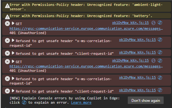

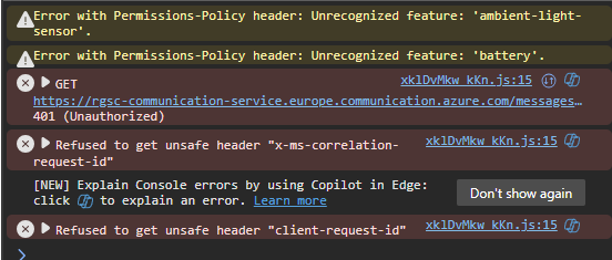

- Any browser console logs or HAR file captured during the error
- See below

Yves Blancquaert • 0 Reputation points2025-11-13T06:31:09.2233333+00:00 -

Thanks for confirming that https://preview.portal.azure.com loads everything correctly — that’s a huge clue! The errors you’re seeing in the main portal (the React crash with “Cannot read properties of undefined (reading 'keyword')” and the 401s) are coming from a temporary glitch in the ACS portal extension, not your WhatsApp setup or resource. Everything on the backend is fine.
