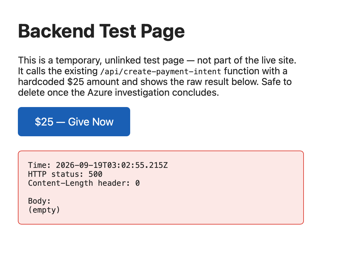

Problem description
I am experiencing an issue with my Azure Static Web Apps where API routes return an empty HTTP 500 error, and no functions are being invoked. Despite the deployment appearing successful, the API endpoints do not respond as expected.
Environment
Azure Static Web Apps, Serverless API hosting, in the Central US region.
What I've already tried
I have ruled out CORS issues, missing environment variables, routing configuration problems, and have confirmed in GitHub Actions logs that the build and deployment completed successfully. I also verified that the api/ping.js function is fully self-contained and returns a hardcoded 200 response, with no shared bootstrap, secrets validation, or database clients involved. I already have an open Developer-tier support request (2609160040009134) on this issue, and the AI-driven support responses so far have not resolved it. I'm posting here as instructed by the support portal in order to continue receiving assistance on the case.
Current status
Currently, I have not confirmed a service-side cause. I am seeking guidance on how to diagnose this further, specifically how to inspect the deployed API package and configuration, or how to force the managed API build to use Node.js 18 instead of the current Node.js 22.22.0, to resolve the issue.

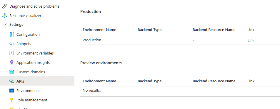

    How to confirm it from the portal
    For managed functions the documentation directs you to Application Insights for runtime logs; logs are only available once Application Insights is added. Before that, two portal views can provide clues about whether the managed API was detected successfully:
    1. In the Static Web App resource, the APIs blade shows one row per environment with the columns Backend Type and Backend Resource Name. When the platform detected a managed functions app, Backend Type reads "Managed" for the Production environment (as described in the 2022 Q&A thread Azure Static Web App not getting response from static web api API Function); when nothing was detected, both columns show a dash. If Production shows no managed backend even though the deployment was supposed to contain api/ping.js, that is additional evidence that the managed Functions app was not detected or registered. Treat the portal state as a diagnostic clue, not as a documented statement about the exact failure stage. SWA: APIs tab Azure Portal
