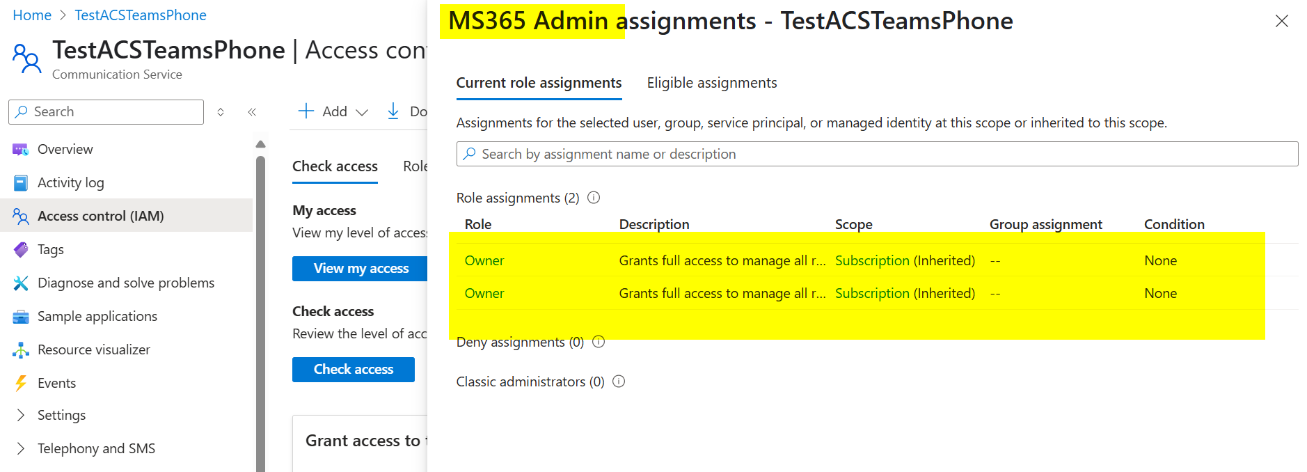

Where can I find the connection status in the “Channels” section of the Copilot Service Admin Center?
How can I see if I have the required authorization to connect?

Thank you for your response.To check the connection status of your Azure Communication Services (ACS) phone number in Copilot Studio, go to the Copilot Studio Admin Center, navigate to your bot project, select “Settings” > “Channels”, and look for the “Telephony (Preview)” channel. Here, you can verify if the ACS resource and phone number are listed and connected. If the phone number isn’t listed or shows an error, try removing and re-adding it using the “Add phone number” option. Regarding permissions, your Azure account must have the Owner or Contributor role assigned to both the ACS resource and the Copilot Studio environment to connect a phone number successfully. You can check this in the Azure portal by selecting the ACS resource and navigating to Access Control (IAM) > Role assignments. Ensure your user account is listed with the appropriate role.
https://learn.microsoft.com/en-us/azure/role-based-access-control/role-assignments-portal -

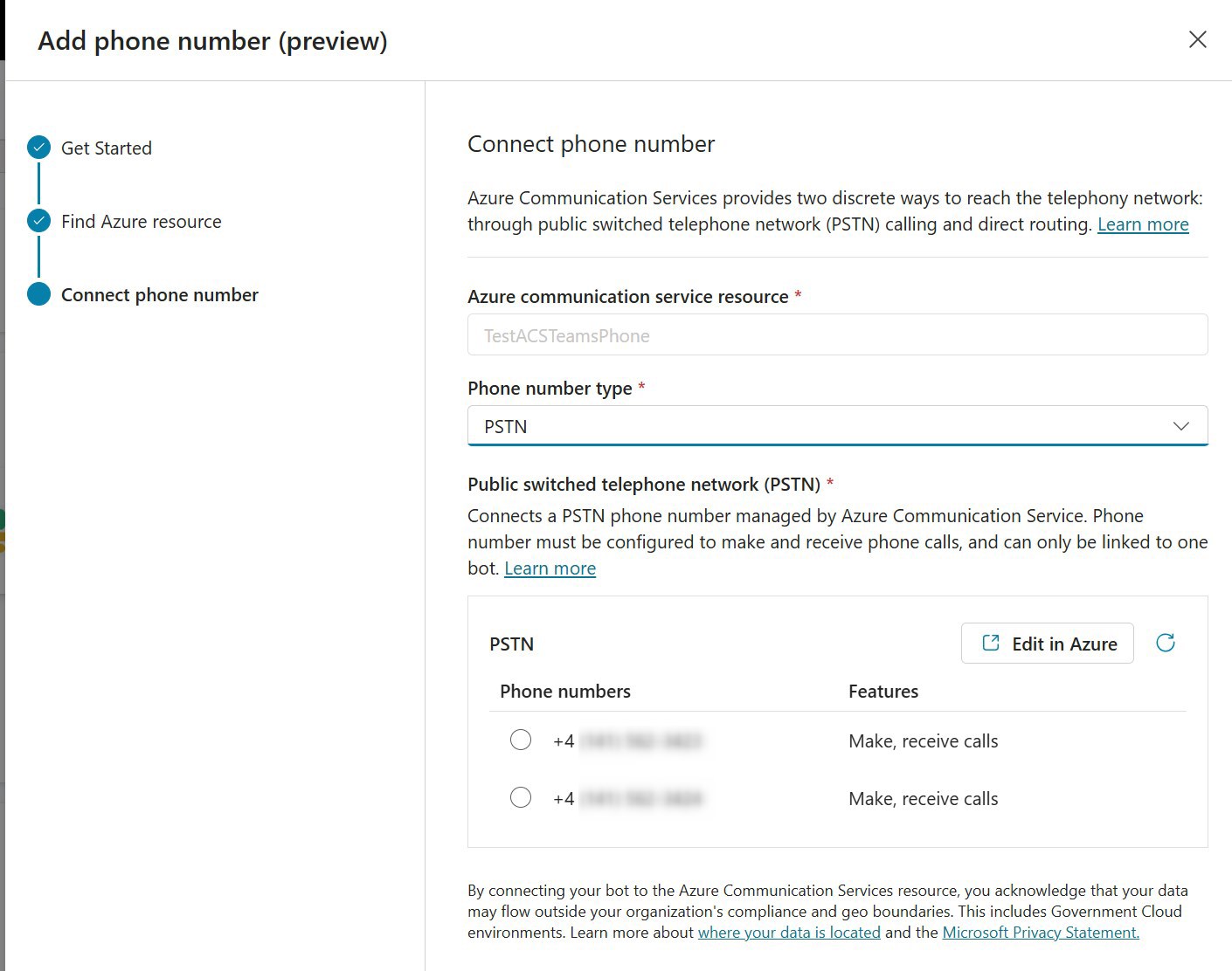

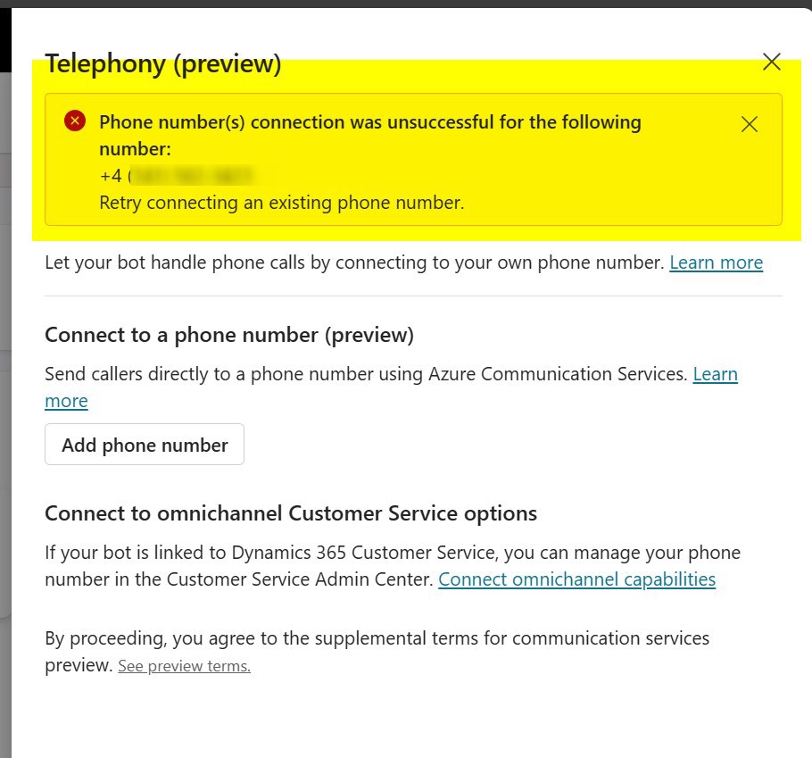

My problem is that I cannot add an ACS Phone number in my Copilot Studio Bot under the Telephony (Preview) Channel. Therefore nothing is displayed. When I add a phone number, I get an error message that says nothing. When I look at the authorization in ACS under Access Control (IAM), I have the Current Role -> Owner. I don't know what the problem is? I can't find any log information under the ACS resource that points to the error, nor do I see anything in the bot. It would be great if I could fix this. Thank you very much for your support. Greetings
Oliver

It sounds like you're encountering an issue with adding an Azure Communication Services (ACS) phone number to your Copilot Studio Bot, even though you have the Owner role assigned via Access Control (IAM). While the Owner role should typically provide sufficient permissions, the generic error message and lack of log detail understandably make this challenging to diagnose.Review Configuration Settings Double-check that your telephony channel configuration in Copilot Studio is complete and that all required fields (e.g., phone number, region, etc.) are filled out accurately.
The phone number must be a PSTN-capable number (i.e., enabled for inbound calling). Ensure that the number is purchased and correctly provisioned in ACS with the "Voice" capability. If the number shows "SMS" or other capabilities only, it won’t be usable with the voice bot.Enable Diagnostic Logs for ACS While ACS doesn’t surface detailed errors in the portal UI, you can enable diagnostic settings for your Communication Services resource via Azure Monitor to capture more detailed logs. This may help uncover hidden issues with the phone number or bot connection.

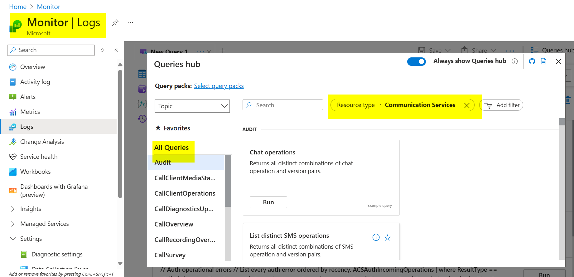

I have set up the Azure Monitor once for the ACS resource. Unfortunately, I can't find any logs regarding the connection to the Copilot Studio Agent. Where should I look?

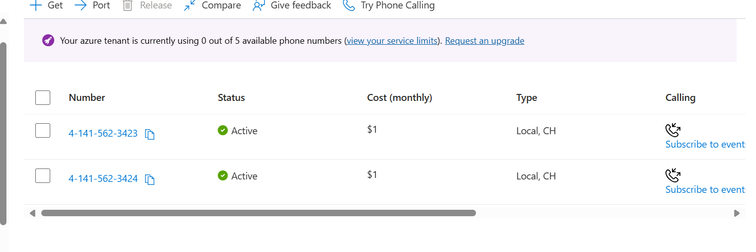

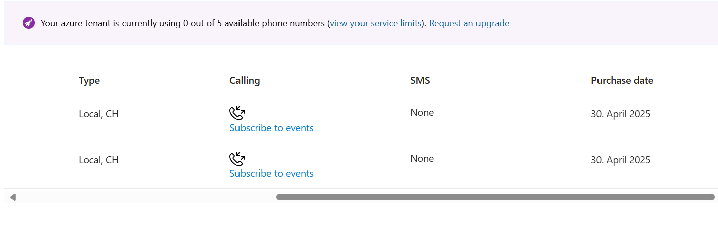

About the phone numbers, I ordered them from Microsoft and got them assigned.
Where can I see if the phone numbers have restrictions?

To check if the telephony channel configuration in Copilot Studio is complete, you should ensure that you have successfully connected to an Azure Communication Services (ACS) resource. If you only see the option to “Add phone number,” it may indicate that the configuration is not fully set up. You can refer to the setup instructions for connecting to ACS and ensure all necessary steps have been completed.Regarding the Azure Monitor logs, you should look for call logs and diagnostics related to your ACS resource. These logs can help you troubleshoot the connection to the Copilot Studio Agent. Make sure that diagnostics are configured correctly in your SDKs to capture the necessary information.
To check if the phone numbers have restrictions, you may need to review the details of the phone numbers in the Copilot Service admin center. Typically, restrictions or limitations associated with phone numbers can be found in the phone number management section.

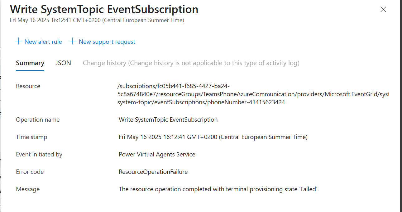

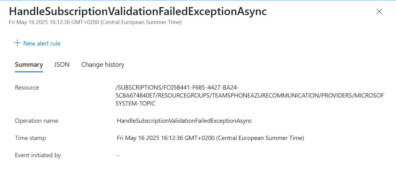

2025-05-16T14:17:15.1133333+00:00 I have found an error message, can you help me? Thank you very much.
Oliver • 0 Reputation points
2025-05-16T14:18:20.5+00:00
Sign in to comment
2025-05-15T08:25:41.0566667+00:00 -
2025-05-16T14:32:03.67+00:00 Hello Shree Hima Bindu Maganti
Extract from JSON
Thanks for your support.
Greetings
Oliver
{\"code\":\"ResourceOperationFailure\",\"message\":\"The resource operation completed with terminal provisioning state 'Failed'.\",\"details\":[{\"code\":\"URL validation\",\"message\":\"Webhook validation handshake failed for https://nuanccsvc.api.il101a.ch.prd.ls.powerplatform.com/ivr-controller/v1/calls/incoming/tenants/c276d79b-4dd1-4d26-9814-d22cfa7c459c/apps/2e50cbbf-dd29-4635-92b2-50259716d0b6. Http POST request failed with response code Unknown. For troubleshooting, visit https://aka.ms/esvalidation. Activity id:eb85d8f6-85ce-49b7-a068-e78f753afc94, timestamp: 5/16/2025 2:12:36 PM (UTC).\"}]}}", "eventCategory": "Administrative", "entity": "/subscriptions/fc05b441-f685-4427-ba24-5c8a674840e7/resourceGroups/TeamsPhoneAzureCommunication/providers/Microsoft.EventGrid/systemTopics/TestACSTeamsPhone-system-topic/eventSubscriptions/phoneNumber-41415623424", "message": "Microsoft.EventGrid/systemTopics/eventSubscriptions/write", "hierarchy": "c276d79b-4dd1-4d26-9814-d22cfa7c459c/fc05b441-f685-4427-ba24-5c8a674840e7"

It seems that you are experiencing a webhook validation handshake failure in Azure Communication Services. This error typically occurs when the endpoint you provided for the webhook does not respond correctly to the validation request from Azure Event Grid.To troubleshoot this issue, you can follow these steps:
Make sure that the callback URL you provided supports HTTPS, as HTTP endpoints are not supported by Call Automation.
Check if your application endpoint is validated with Event Grid when creating the event subscription. The provisioning status for your event subscription should be marked as succeeded if the validation was successful.
Look at the logs of your service to see if there are any errors or issues that could provide more context on why the validation handshake failed.
For more detailed troubleshooting steps, you can refer to the Azure documentation on webhook validation and troubleshooting.

2025-06-06T10:02:44.6166667+00:00 Oliver, when you try to connect a phone number, ACS reaches out to the web address you provided to make sure it can deliver events there. If that address doesn’t answer exactly the way ACS expects, the connection quietly fails, and you see that unhelpful “ResourceOperationFailure” message. In other words, ACS tried to send a small test request to your webhook URL, didn’t get the right reply, and gave up.
To fix this, your bot’s webhook URL needs to be a real HTTPS address that anyone on the internet can reach (no firewalls blocking it, and the TLS certificate must be valid). When ACS sends its validation request, your service should read the JSON it receives, pick out the “validationCode” value, and immediately send back a JSON response that looks like this:
{ "validationResponse": "<the exact code ACS sent you>" }
If your service does not reply with that exact JSON, ACS assumes it can’t talk to your endpoint and cancels the setup. You can check reachability yourself by opening a terminal (or PowerShell) and running something like:
curl -v https://your-webhook-url/ivr-controller/v1/calls/incoming/…
You should see a quick “200 OK” with either an empty body or a simple confirmation message. If curl times out, rejects the certificate, or shows any error, ACS will fail the phone-number connection for the same reason.
Finally, make sure the identity Copilot Studio uses has permission to manage calls on your ACS resource. In the Azure portal, go to that Communication Services resource, open Access Control (IAM), and verify that the Copilot service principal or managed identity is listed with a role like “Communication Services Caller.” Without that role, ACS won’t let your bot subscribe to events or answer calls, even if your webhook is perfect.
Once your webhook is publicly reachable over HTTPS, always echoes back the validation code, and your Copilot identity has the right ACS role, you can try “Add phone number” again. The number will move from “Pending” to “Connected,” and incoming calls will flow straight into your Copilot Studio voice bot. Then you can pick up the speech-to-text results, look for keywords, and forward callers however you like.
