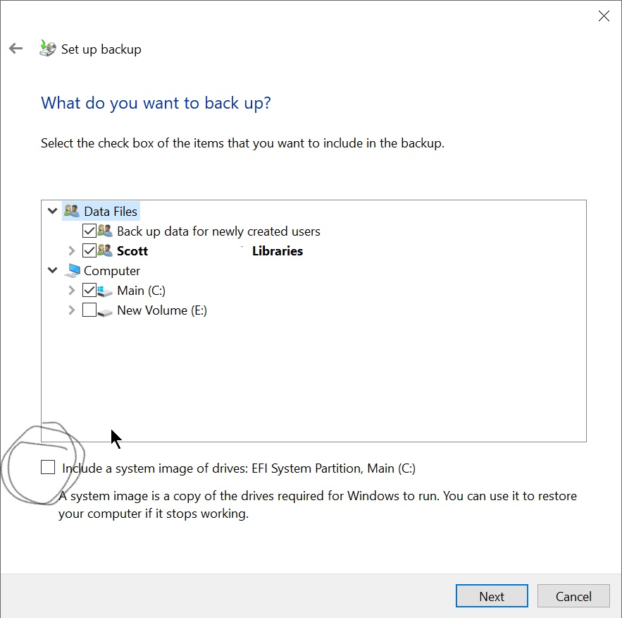

I had the same issue till now. I believe the problem is the EFI partition while the Windows trying to back up EFI partition with the image of Windows 10 if back up driver was not been formatted with EFI partition baciking up stops. so the solution is that when you choose what do you want to back up options choose "Let me chose " and in the next screen unmark "include a system image of drivers:EfiSustem partition"
It should be it.
