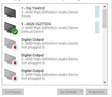

    When you type mmsys.cpl in the search and hit enter. what's all listed. If you don't mind, share a screenshot on the playback tab, and another on the recording tab.
    2024-06-21T16:33:37+00:00
    There's quite a few sorry about that
