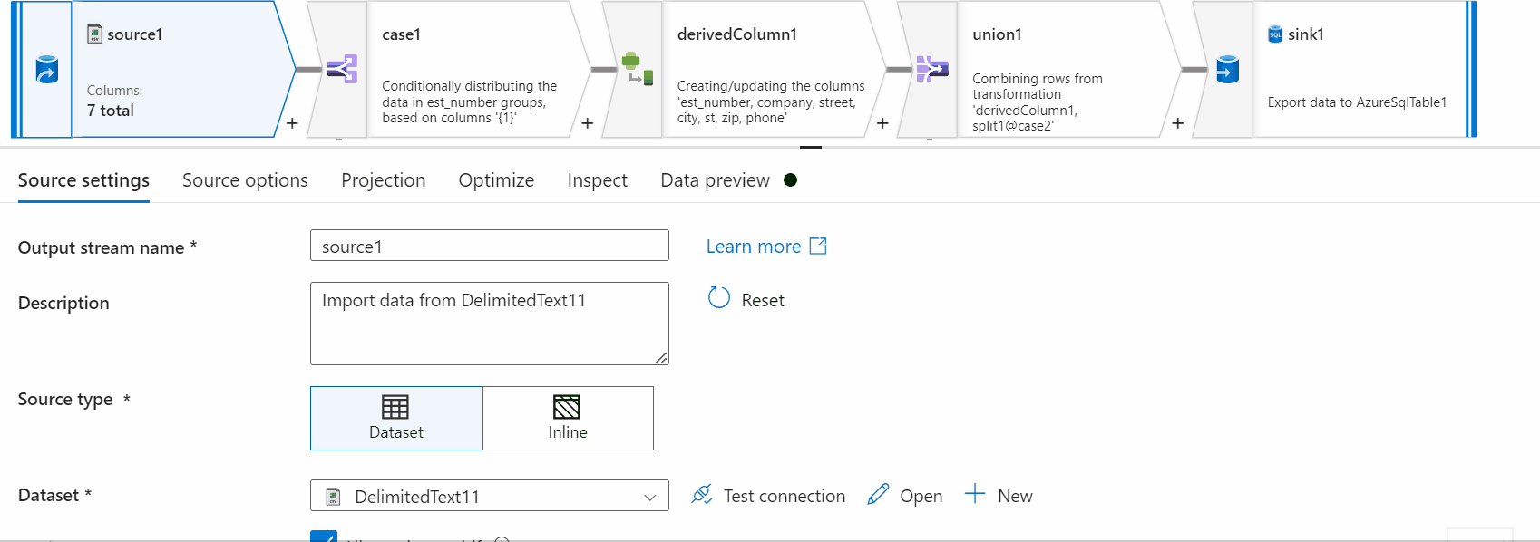

    So, as mentioned correctly by @AnnuKumari-MSFT if there is no data in sink, there is nothing to update on as it is an action to be performed on the sink. However, you can perform transformations on the source data using several transformations present in dataflow. For this case:
    • You can use a filter transformation or conditional split transformation to divide the whole dataset into two parts one having est_number='V18677A' and rest others will fall under default case.
    • Then you can use derived column transformation to modify the St column to 'MN'
    • Afterwards, you can union the two datasets using union transformation.
    • And use Sink transformation to load the data into SQL
    In this way you don't need to insert the source data first and then perform transformation for updating the data in sink because before inserting we are taking care of the transformation.

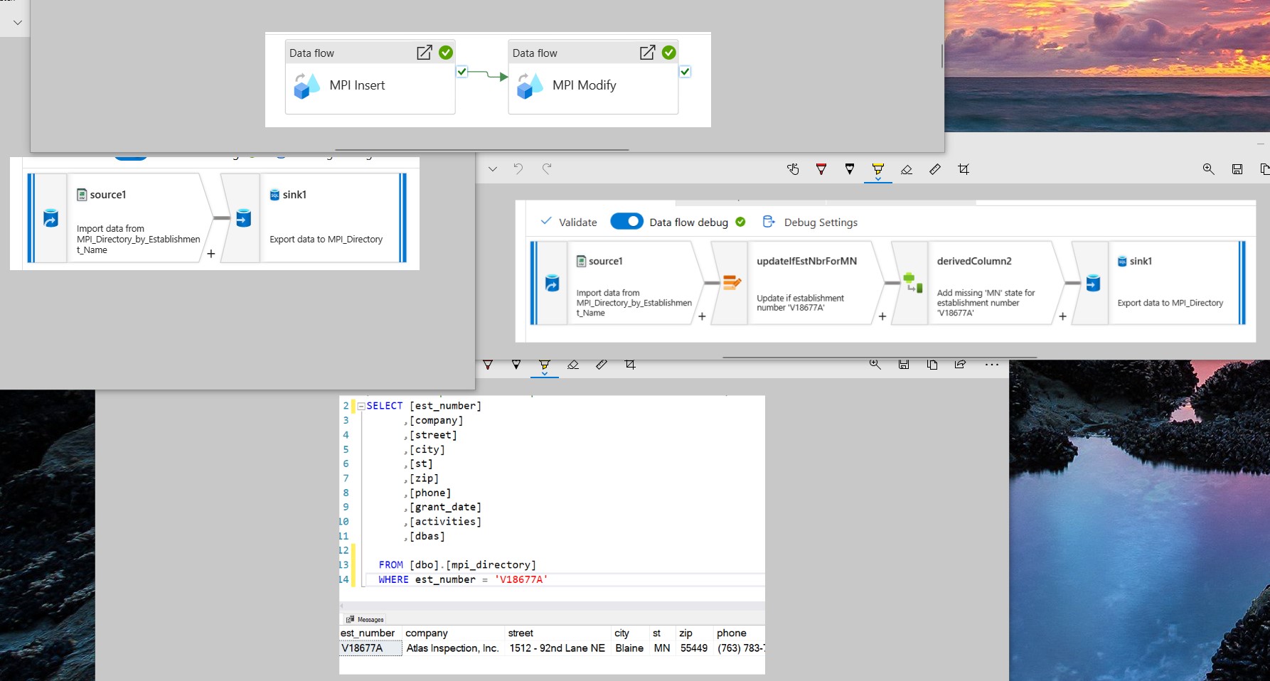

    I understand you are trying to update the rows which are matching the condition est_number=='V18677A' , however, you can see no data in the sink table.
    The reason for having no data in the sink table is because you have used the truncate table script in pre-copy script option in sink settings .
    Because of that, the whole table is getting truncated and there's no rows to be updated even if it's matching the condition for at least one row. Kindly reinsert the data and then try same configuration except truncate table script.
    I tried to reproduce your case, I am getting the result as expected.
