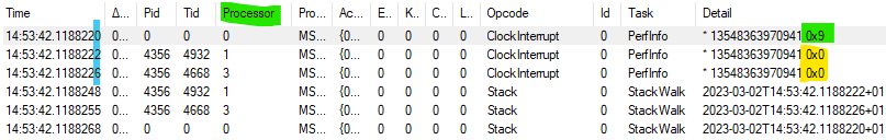

  1. Gary Nebbett 6,081 Reputation points
    2023-03-02T14:41:02.7566667+00:00
    Hello Martin,
    I think that I am getting closer to understanding what is happening and that suggests to me that you will have to update your performance analysis techniques.
    Using ETW under Windows 10, one often sees sequences of events like this:
    The first clock interrupt entry is the hardware clock interrupt; the lower bit of the final value for that entry indicates that this processor (0) is the clock owner. The next two clock interrupt entries occur as a result of an interprocessor interrupt (IPI) - this can be verified by examining the stacks for the three clock interrupt events. The clock interrupt is forwarded, via IPI, to all processors that are not "idle".
    This behaviour gives the results for CPU usage time that you have observed up to Windows 10.
    Under Windows 11, I see this:
    The differences are that a new bit (mask 0x10) is set on all clock interrupt events and clock interrupt events always occur just once per "tick" (i.e. no instances of clock interrupt events separated by tenths of microseconds on different processors).
    This could just be an artefact of ETW tracing under Windows 11, but it ties in nicely with the observed behaviour of the thread/process CPU usage counters. More work is needed...
    Gary

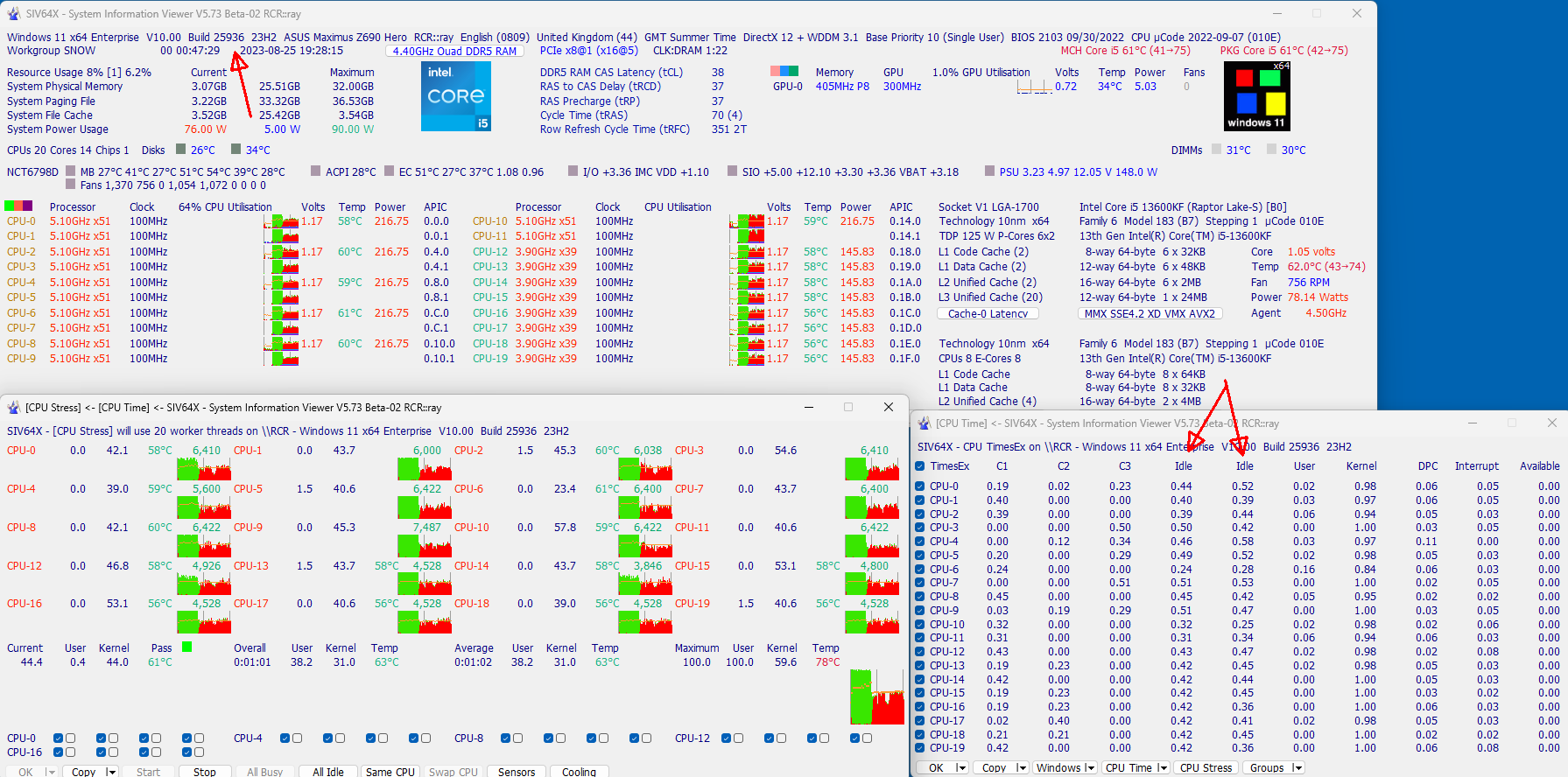

  1. dmex04 6 Reputation points
    2023-09-05T00:42:40.87+00:00
    I know this as it's been fixed in todays 23H2 Build 25936
    @red-ray
    Nothing changed? Check the disassembly of those kernelbase functions, they're still using the exact same broken NtQuerySystemInformation behavior as previous versions of Windows.
    The SIV64X tool in your screenshot however was updated and their changelog mentions a workaround... They're now bypassing kernelbase.dll (NtQuerySystemInformation) and are instead calling NtQuerySystemInformationEx directly which is why you're seeing correct values from SIV64X - everything else using GetSystemTimes/GetSystemInfo from kernelbase (NtQuerySystemInformation) still has issues with Windows 11.

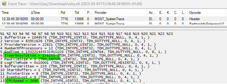

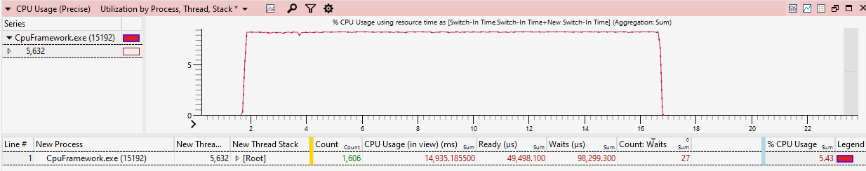

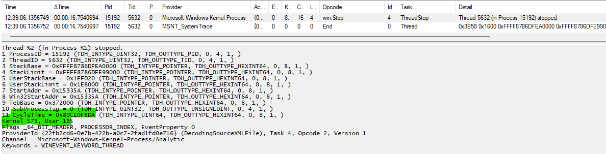

  3. Gary Nebbett 6,081 Reputation points
    2023-03-01T13:58:57.9733333+00:00
    Hello Martin,
    Thanks, the trace data is good. Below are some easy representations of the data.
    The CPU usage of the "busy" thread is 14935.1855 milliseconds, measured with 0.1 microsecond accuracy of the time between switch-in and switch-out events. Some time was spent waiting, but probably during thread start-up and run-down.
    When the thread stopped, it had accumulated 573 CPU units in kernel mode and 165 units in user mode. (573 + 165) * 15.625 = 11531.25 milliseconds. Its "CycleTime" was 0x89CE0FBDA = 36991728602 units. The "nominal" "CPUSpeed" is 2496 MHz; 36991728602 / 2496 = 14820 milliseconds.
    The "busy" thread mostly runs on processors 0, 1, 2 and 3. 36991728602 / 11531 = 3208 MHz. This is plausibly a mix of the frequencies of processors 0 to 3.
    More work is needed to investigate whether CPU frequency actually accounts for the numerical results and whether some system/CPU characteristics (such as whether RDTSC is a constant rate counter) are being incorrectly queried/read.
    Gary
