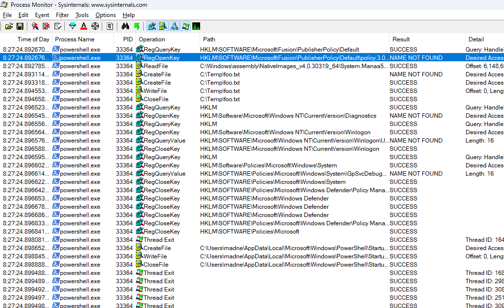

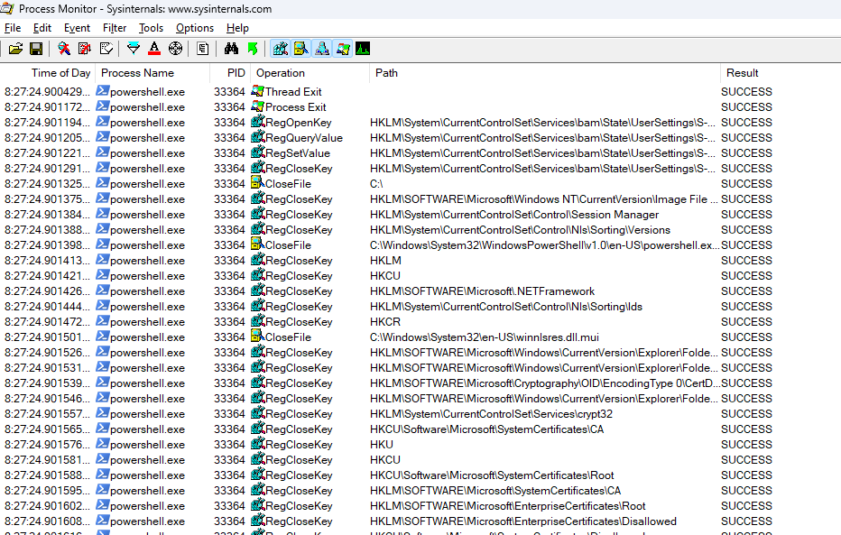

    My favorite Crystal Ball tool is Sysinternal's Process Monitor.
    https://learn.microsoft.com/en-us/sysinternals/downloads/procmon
    Use it to trace the PowerShell and SQL processes.
    For example, I ran this.
    powershell "'xxx'|out-file c:\temp\foo.txt"
    In the trace I see PS writing to my txt file and then starts terminating threads as it cleans up.
    After the final thread exit, I see a process exit followed by registry cleanup. That all occurs in under a second.
    Where do you see the 8 second gap? Does it occur before or after the Process Exit? What entries are in the trace during those 8 seconds?
