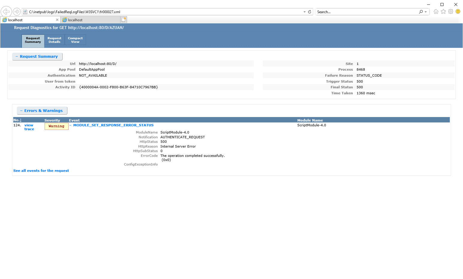

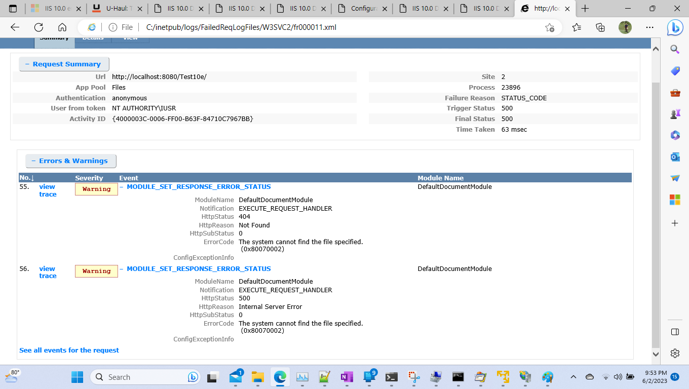

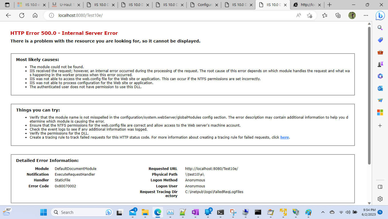

    I was able to recreate your error using my laptop to access my test10 VM.

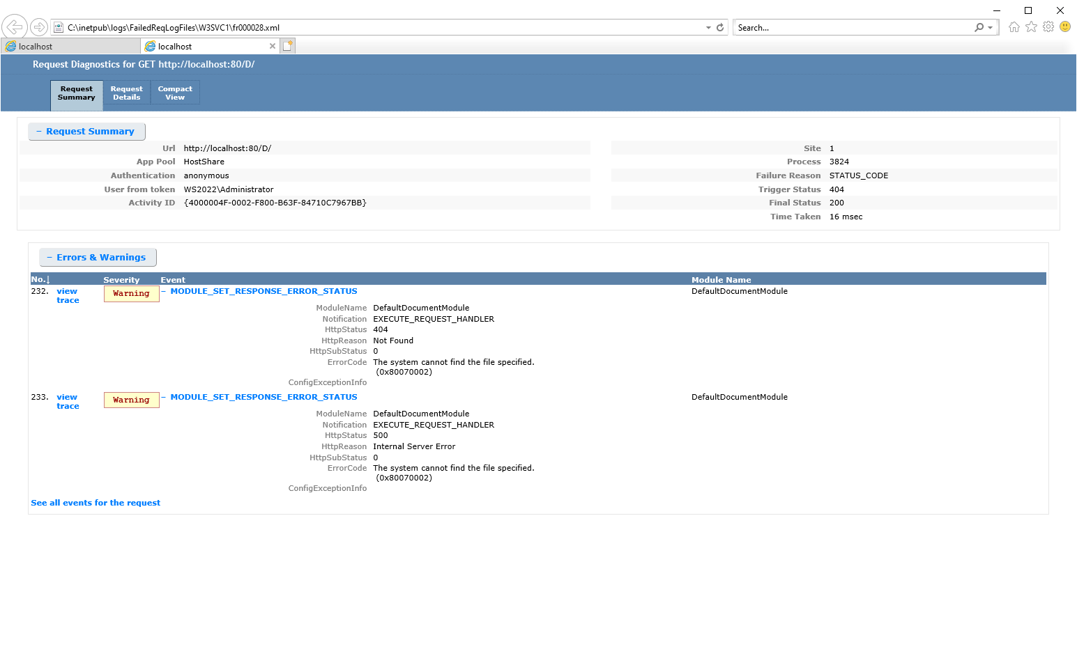

    Failed request tracing shows the default document handler not finding "something".
    I tried every trick I know of to get this to work and it fails every time. I traced both machines with Process Monitor and nothing shows up as "access denied" or "file not found".
    There is something about referencing the root of a drive that IIS just does not like.
    I did get it working by changing the virtual directory to point to a subdirectory on the share.
