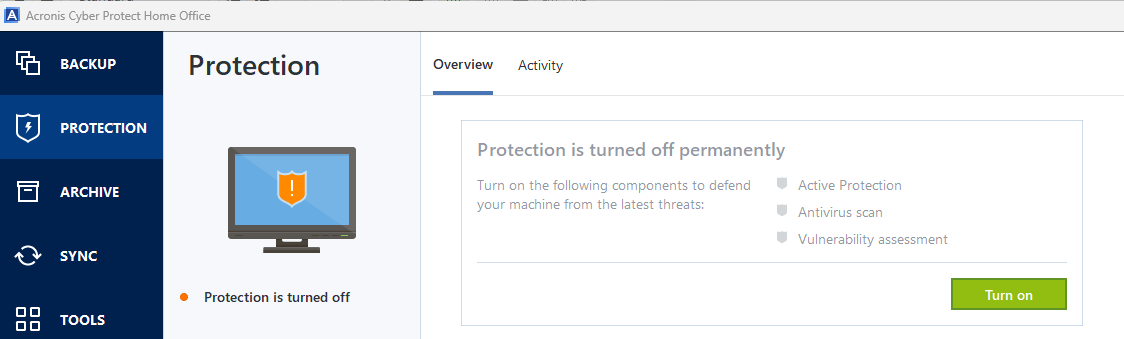

Mohammed Jaafar 35 Reputation points
2024-03-15T09:57:06.53+00:00
Update
I might have found the cause, as 5 of out of 6 reboots the drives appeared
I began getting the result after I disabled Acronis's Protection module
now I have to see if it carrys on like this
