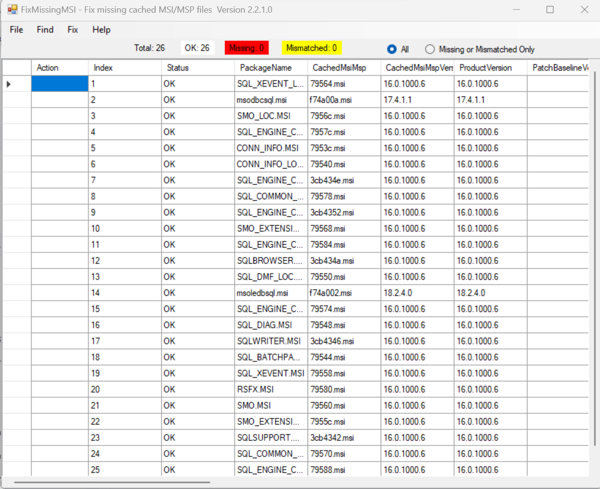

    In addition to that, there is another way to resolve missing MSI files.
    You may use the FixMissingMSI tool to identify MSI file that are missing from the Windows Installer cache.
    Please download it from here.
    Next, you can scan the folders which you need to repair. For the details, please refer to FixMissingMSI Readme,
