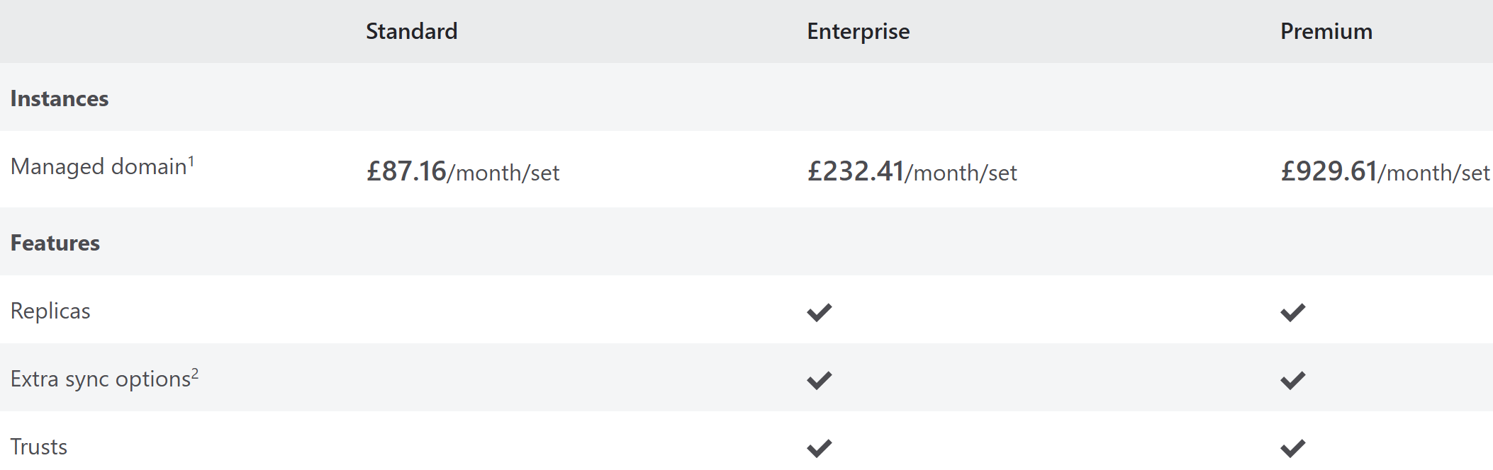

  • SKU's as per the below, why is Enterprise cheaper than premium, unless I've read this wrong the main difference between Enterprise and Premium was daily backups vs 3 day backups (note that Standard is not an option as we would like support for forest trust).

    Regarding Enterprise vs. Premium SKU
    • As you pointed out, the Premium SKU includes the additional capability (daily backup frequency) that caters to specific, high-demand scenarios where recovery points need to be more frequent.
    More at https://learn.microsoft.com/en-us/entra/identity/domain-services/administration-concepts#azure-ad-ds-skus
