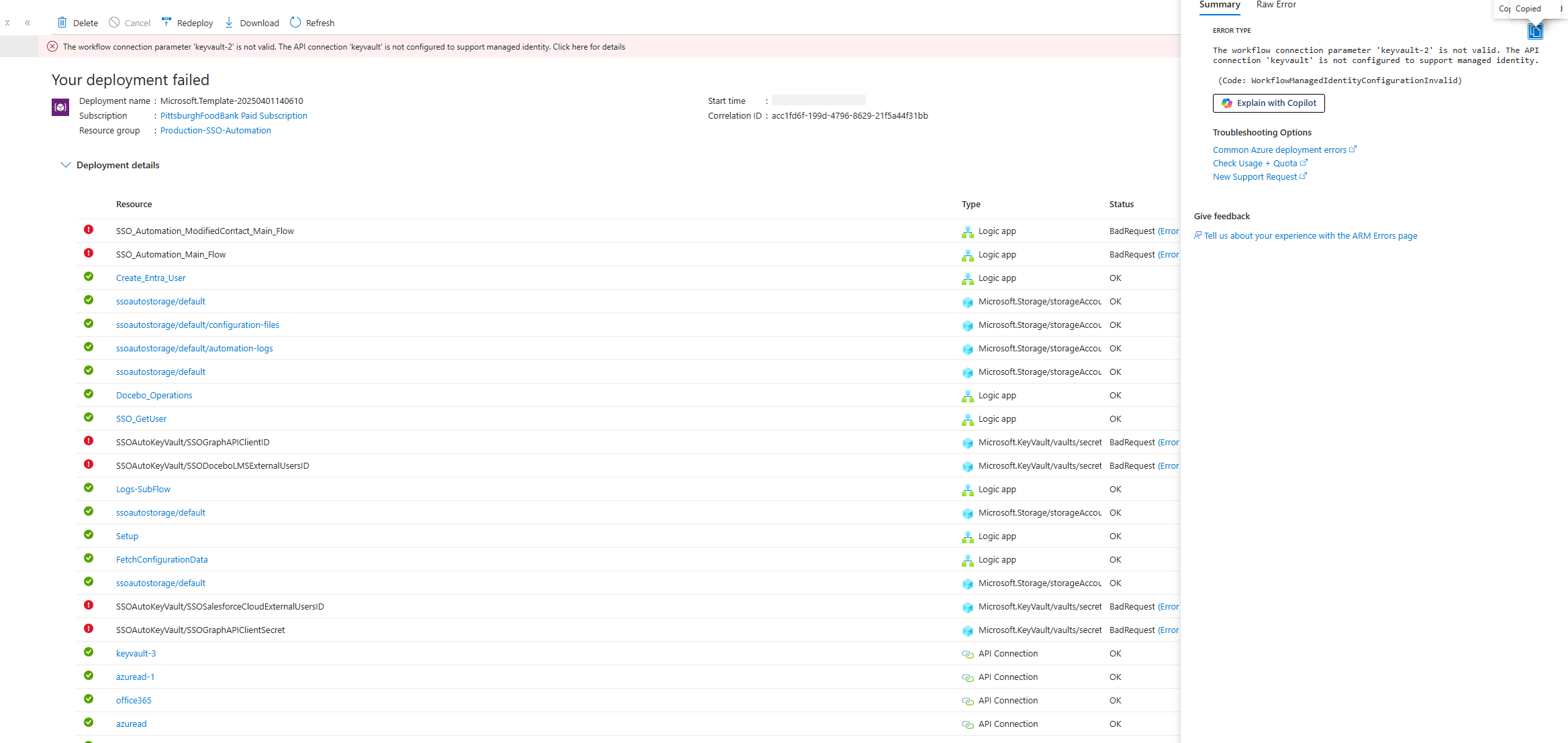

When migrating the code from a development environment to a production environment, the Key vault migration API call fails to be migrated with the Authentication type as Managed Identity.

    • After checking and performing the re-deployment we have found the same error " {"code":"WorkflowManagedIdentityConfigurationInvalid","message":"The workflow connection parameter 'keyvault-2' is not valid. The API connection 'keyvault' is not configured to support managed identity."} "
